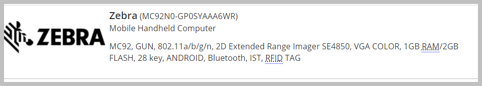

    • Meenakshi Singh
      November 2, 2021 at 9:42 AM
      Hi John,
      This is the model that we had used for scanning from barcodeinc.com
      Hope this helps,
      ~Meenakshi

      November 2, 2021 at 11:58 AM
      Thanks a lot! I will definitely look into that device.
