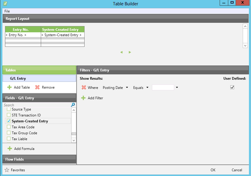

      One thing IT can do if you have access is go into SQL and query the G/L Entry table to count the entries and system-created entries to see what percentage of your general ledger entries are entered by a human. Alternatively, you can use Jet Express to run this query.
      I would suggest looking at this as a general ledger entry table with a high proportion of user-generated entries may trigger more need for reconciliations. This is because you want the system to post all the appropriate transactions from the subsidiary ledgers to the G/L, not a person.Ā

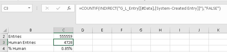

      In Excel, one way to get this data out of the Jet Express query is with a COUNTIF formula
      The % human entries should be low. If you include account number, you can filter by account to see what the ratio of non-system-created entries to entries is for a particular account. I would suggest filtering by the control accounts found in the specific posting group setups.
