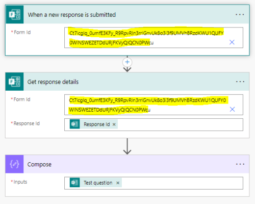

    When working with Power Automate and using the Microsoft Form connector, sometimes the ‘Form Id’ filed of the Form connector does not show up the list of Forms available to you and it is not possible to automate tasks because of it.
    A simple way to overcome this little issue is to go to the Form itself and extract the ‘Form Id’ from the url and paste it at the form id field -after selecting ‘Enter custom value’-.
    This way allows to use all form fields and automate processes, like collecting responses and store it into a SharePoint list.
