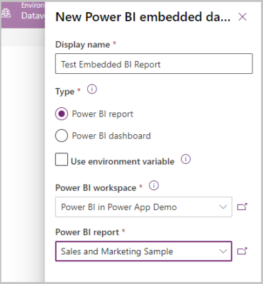

    If you try to insert or embed a Power BI visual or dashboard into Power Apps, make sure that you bring a Power BI visual, or dashboard already published into Power BI Service. Make sure to enable the Power BI visualization embedding setting for your environment from the Power Platform admin center.
    Once this is done, you can embed this into Power Apps:
    1. Select +New > Dashboard > Power BI Embedded.
    2. Select or enter the following options, and then select Save:
      • Display name: Test Embedded BI Report
      • Type: Power BI report
      • Power BI workspace: Power BI in the appropriate workspace created
      • Power BI report: (the report created and hosted at the right workspace)
