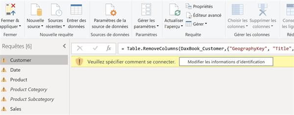

      If I share such a .pbix file with a third-party, will he be able to open the Query Editor and see all the applied steps all the way up to the source data? Considering that they won’t have the .txt source data files saved on their computer?
      According to what I’ve observed so far, is that when you try to open the query editor from a .pbix file where the source data is not located on your local drive you get an Error Message prompting you to update the Data Source Settings, as you can see below:
      As a result, you will not be able to see how the data was like at the time of import.Ā And this is the exact behaviour that I want to get from Power Query when sharing my .pbix files.

      You are correct – but I would still recommend testing with a trusted 3rd party.Ā
      The user will be able to see the final data in the data view pane, but not the steps used to get there.Ā
      The steps are in the query editor, and they will see errors when they open it if the source is not reachable.Ā
