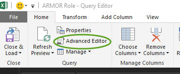

      In your Excel table, open the Query Editor (Data > Show Queries, Query > Edit), select your query (if there is more than one), click “Advanced Editor”, and copy the text (M language).
      Excel Query Editor Advanced EditorFrom there copy all the text.Ā  Open Power BI Desktop.Ā  When you add new data, choose “Blank Query”.
      Power BI Blank QueryDelete the template text and paste the M script you copied from the Excel Advanced Query Editor window.Ā  You may have to provide credentials the first time.Ā  After you save and apply, your dataset is ready.Ā  You’ll have to recreate your Power BI visuals.Ā  Maybe you could replace the M script that gets data from your Excel spreadsheet instead of a new Blank Query, but I’m not sure whether that will work.
