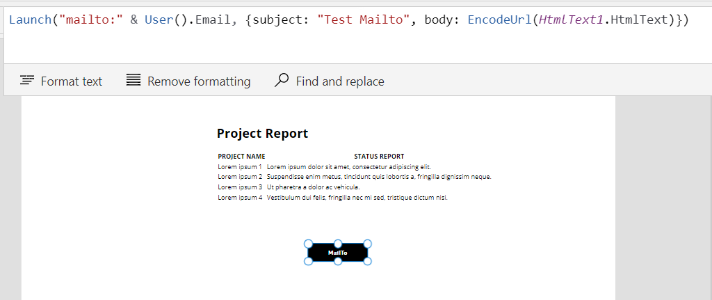

    • Harold Kless
      December 29, 2021 at 12:05 PM
      I tested your expression, and the Outlook window is displayed.
      I’m just using the default text for the HTML Text control.Ā Ā
      The body of the message shows the html tags.Ā
      If you are submitting the body of the message, why not use the Office365 Outlook connection to just send and email without launching Outlook.
      Harold

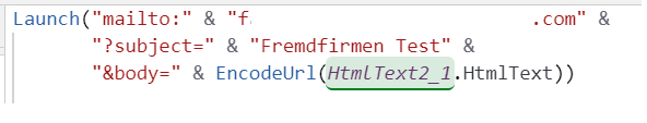

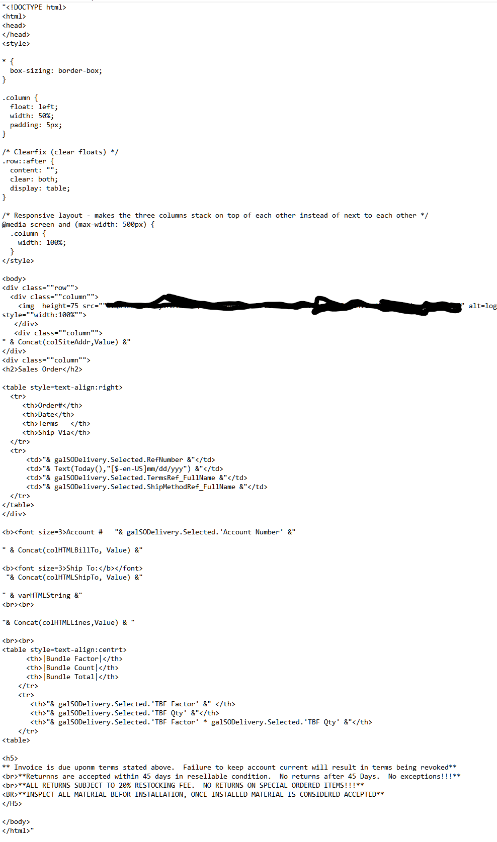

    • Fabian Heil
      January 10, 2022 at 7:43 AM
      Thank you for your input! I still didnt get it to work yet.
      To explain my scenario: The user who opens the new email wants to add some manual data, therefore i use a mailto link instead of sending the email directly.
      Changing the double quotes to single quotes didnt help. i created an easy example but that also doesnt work.
      This is how the html looks like. As soon as i remove the “concat” row, it works.
      Fabian Heil
    • Warren Belz
      January 10, 2022 at 4:51 PM
      Try the original without EncodeURL – I have never uses it and simply sent the HTML Text?
      Warren Belz
      Queensland Australia
