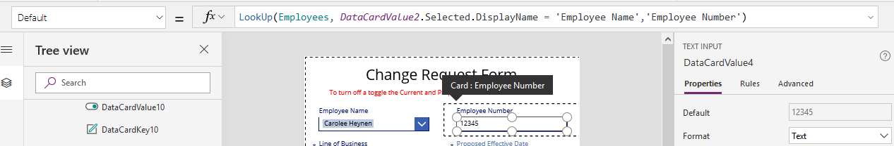

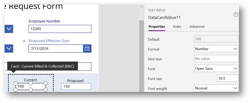

      Suddenly today all the fields in my Power App present with a default value pulled from one of the test entries and I don’t know how to zero it out.

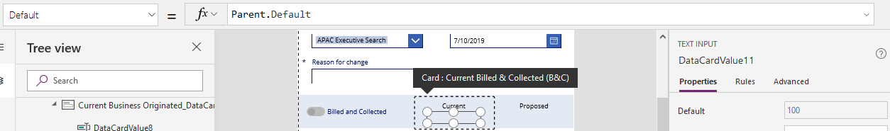

      Most of the fields simply have a Default value = to the test entry, while the formula is Parent.Default
      Value remains
      Here is one that has a formula in “Default” but is still showing a value in the Properties panel…Ā  How do I fix this?
      Default value 12345
      I have been manually entering Blank() for Default, which seems to work… But is this even the right syntax?
      Is this the right syntax?

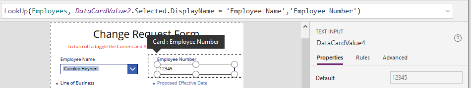

      Here’s a better shot of the first scenario…
      Where is this coming from?

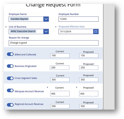

      But up until yesterday when I went to edit the form in PowerApps, the fields were blank.  Shouldn’t the edit process, when I go to it from the list ribbon “customize forms” shouldn’t the form and not from editing a specific item, show a blank form?
      Mine shows up completely populated with values that seem to be hard coded into the “Default” of each field… And are from a test entry that I have since deleted
      Look at “Default”

      I am obviously very new to all of this and I appreciate your input.  My datacard controls seem to usually have a default setting of Parent.default…  does that seem right?

      That is the norm for a form in “Edit” mode – that will get the current value from the item in the list.

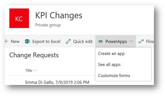

      I have not communicated properly, it seems.  I am not trying to edit an item in the SharePoint list.  I am trying to edit the form itself, in PowerApps, accessing the Studio via the “Customize Forms” link in the ribbon of the list.
      In any case, I seem to have been able to get back to a working state by deleting all the items in the list and then going to customize.

      When you customize a SharePoint list form with PowerApps, while you’re designing the form, it will always have the data in it, of the first item in your SharePoint list.Ā  Here’s how to see where that is automatically set up.Ā  Select your form control (it’s usually called SharePointForm1), and take a look at the property called “Item”.Ā  There, you’ll see the code, that’s basically telling it to show whatever item is currently selected in SharePoint, and if nothing is selected, show the first item in the SharePoint list.
