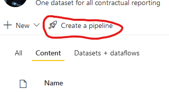

      You create workspace. eg. ‘ML Business Reporting‘. Then you use Power BI to create Developer environment – click ‘Create Pipline
      PowerBI will automatically created additional Workspaces

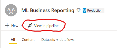

      When you created Pipeline the icon changed to:

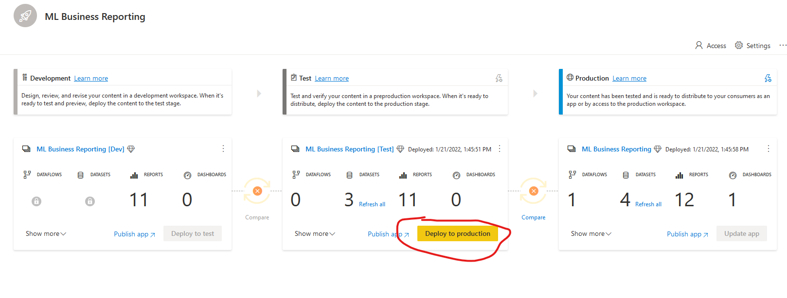

      And when you click this you’ll get this view:
      Just click ‘Deploy to production’ and you dont have to copy/update anything. You can deploy all files or you can pick one or two ore more from list under ‘Show more’
