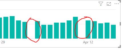

      It’s driving me crazy, but I have missing bars in my bar chart where I know there should be a bar.Ā Ā
      I want to track the new registrations from my website every day, summing up the new registrations over the previous 7 days, so I created this measure:
      WeeklyRegistered = CALCULATE(
      Ā  DISTINCTCOUNT(users[userid]),
      Ā  DATESINPERIOD(users[register_timestamp_PST], LASTDATE(users[register_timestamp_PST]), -7, DAY)
      Works great for the most part.Ā  However, in my data set, I have a few days where there were no new registrations on that day.Ā  When I go to chart this out with the date along the X axis, all of the days have the correct info except days where there were no registrations.Ā  Instead of still summing up the previous 6 days which did have registrations, I just get an empty space in my chart.Ā  Looks like this:
      Any help would be useful.Ā Ā

      April 19, 2020 at 6:20 AM
      Hi Matthew,
      In your Power BI model, do you use a distinct date table (connected to your fact table) ?
      This is most likely the reason of these blank spaces.
      More on that there : https://www.sqlbi.com/articles/creating-a-simple-date-table-in-dax/
