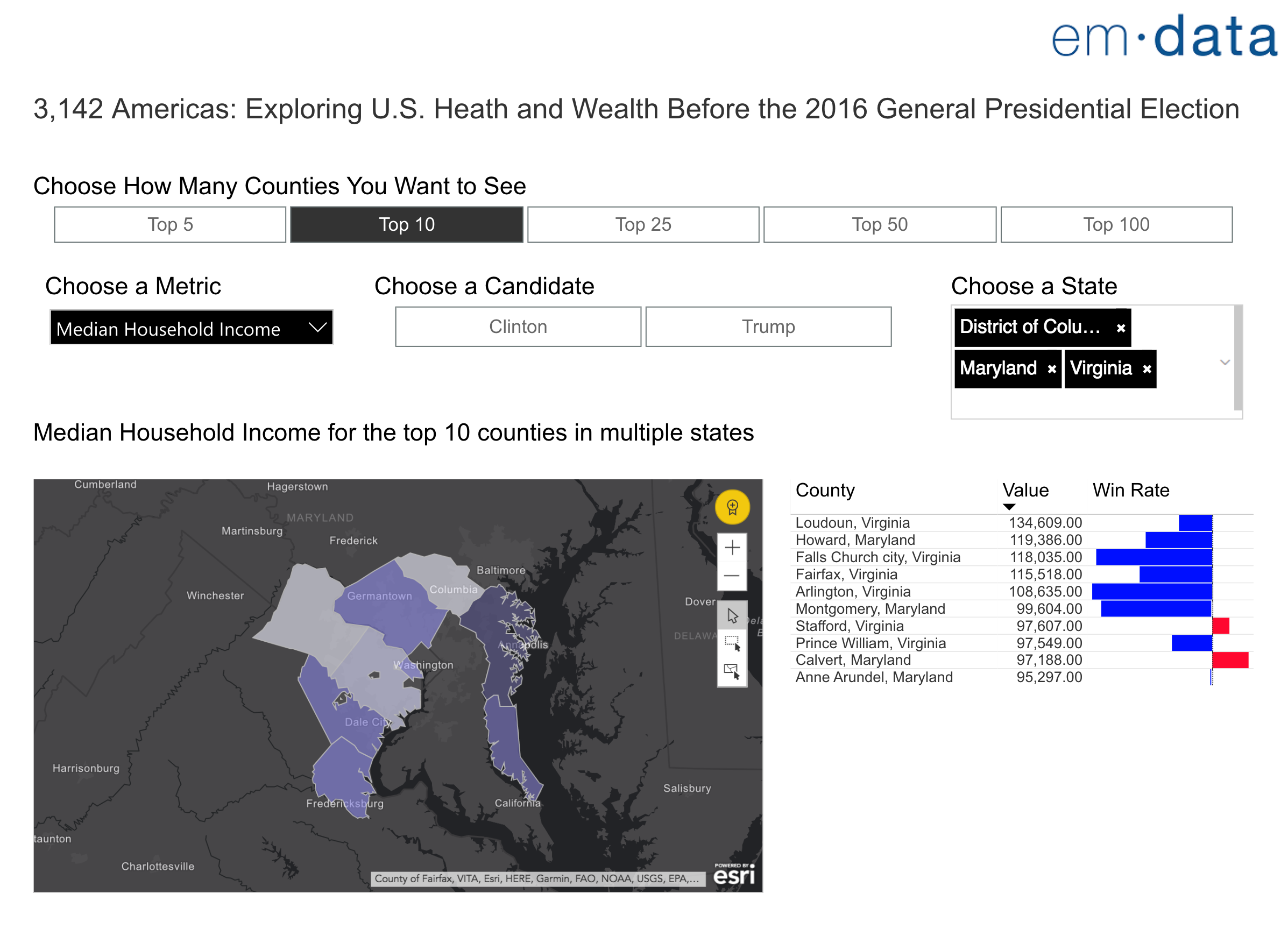

    • Tony McGovern
      January 15, 2018 at 10:08 PM
      Dan,
      What sort of problem are you having trying to display county-level data? Which map are you using?
      I’m having a lot of success working with county-level data with ArcGIS Maps from Esri. See an example below:
      Tony

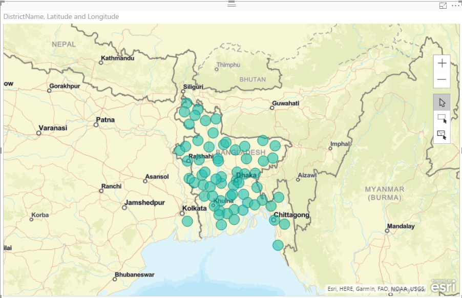

    • Tanvir Anik
      January 16, 2018 at 2:43 AM
      Hello Friends,
      I would suggest using the ArcGIS maps to overcome this issue. I faced a problem like loading 0.1 million locations in the map (tried with both shape map andĀ  common map). The map becomes slower and when a slicer value is chosen to filter data in the report, the map performs more slower.Ā
      Here is a sample ArcGIS map with my country data. Screenshot attached. It works fine for me.

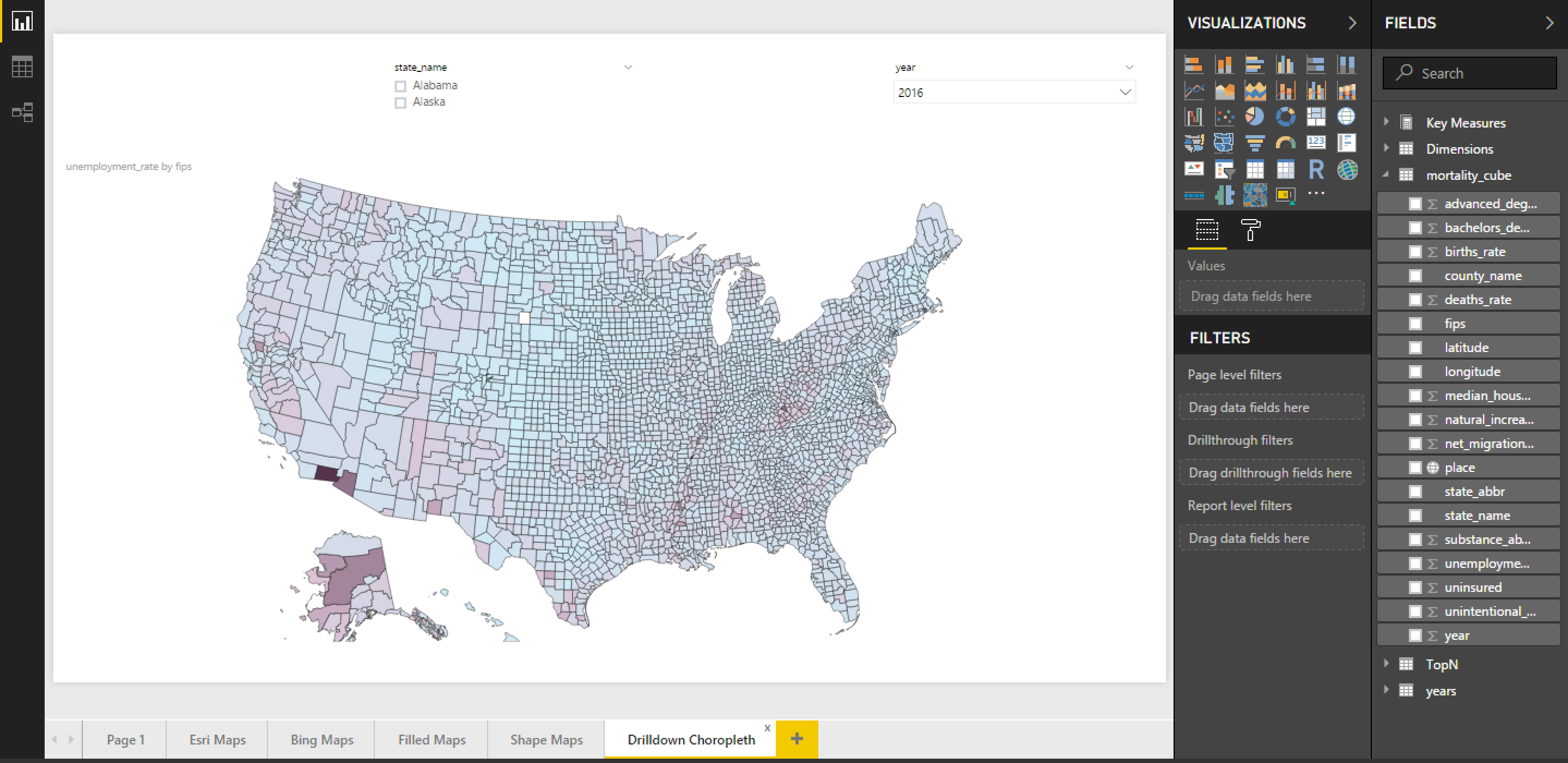

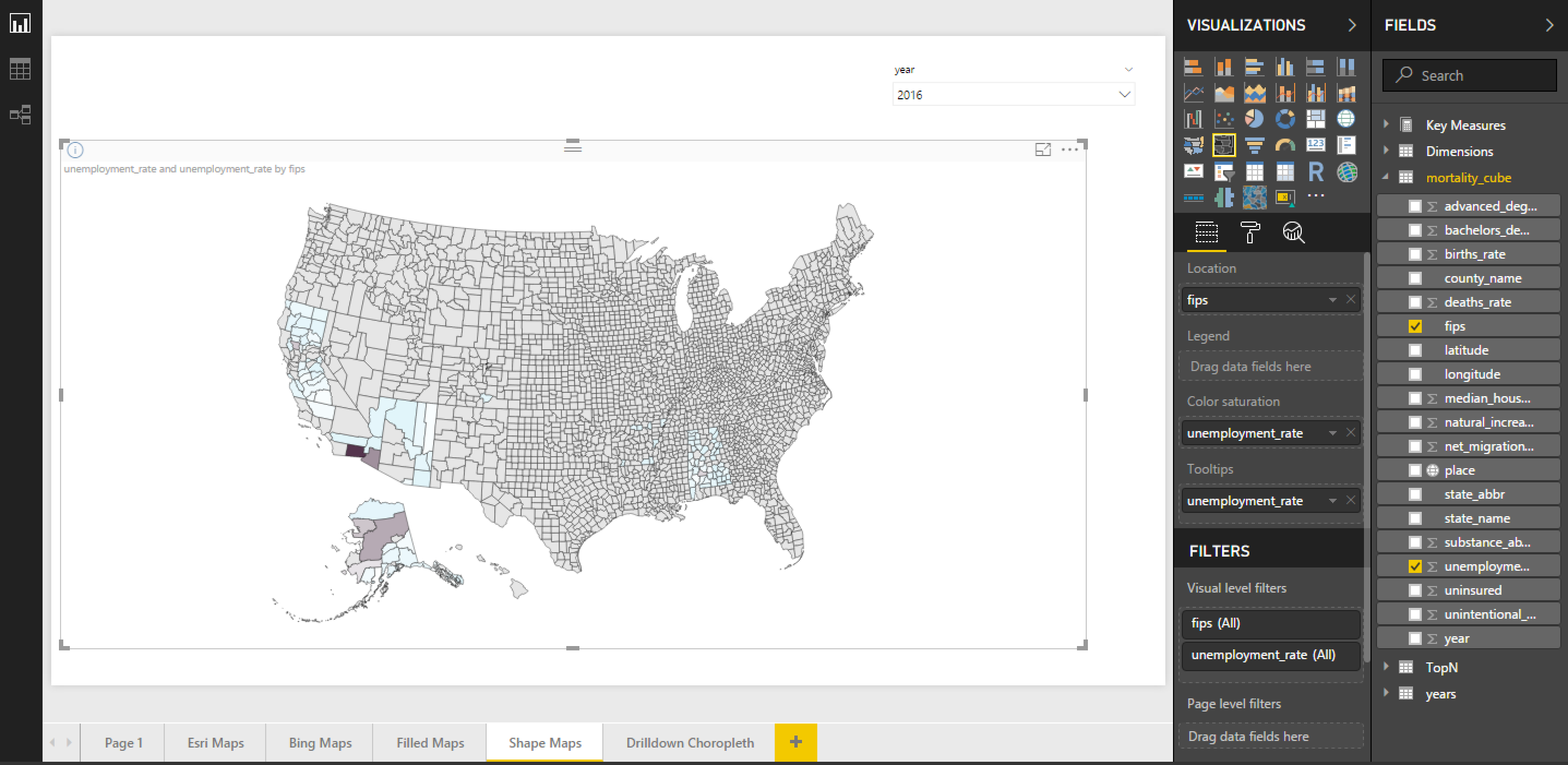

    • Tony McGovern
      January 17, 2018 at 9:37 AM
      Shape Maps and Drilldown Choropleths both support FIPS. Shape Map visuals are limited to about 100 counties. Filled Maps support county and state names defined as a County Data Category.
      Examples:
      1. Filled Map
      2. Drilldown Choropleth
      3. Shape Map
      How are you constructing your TopoJSON?
