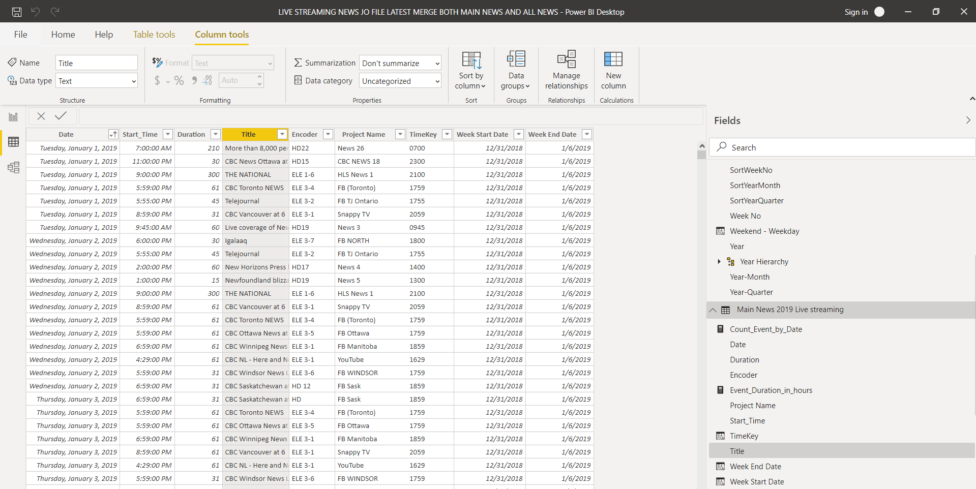

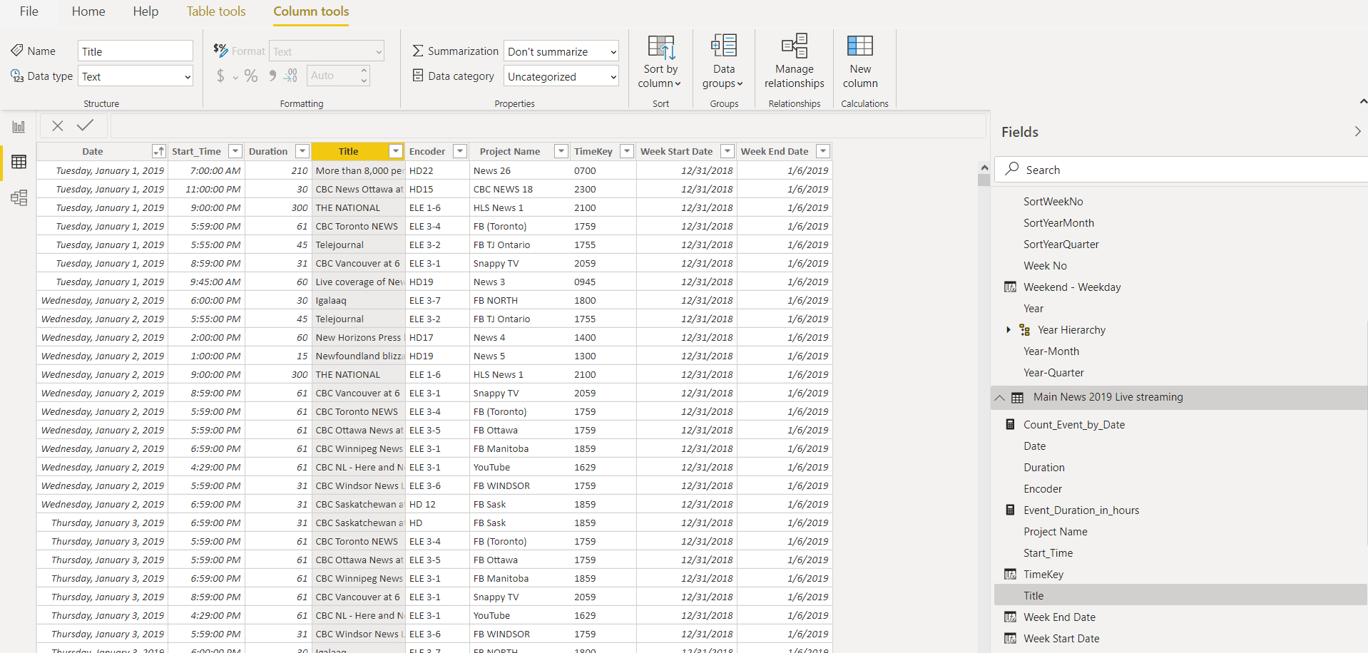

      I don’t have an End Date column and I’m trying to create one. I’m not sure how I can do that.
      I hope that someone can please help explain to me the way that I can add my Duration column to my Start Time to create an End date column. Is this possible? There are times that the Duration is 300 minutes and our shows start at 11 PM and the dates is the next day.
      Is it possible to do this?Ā

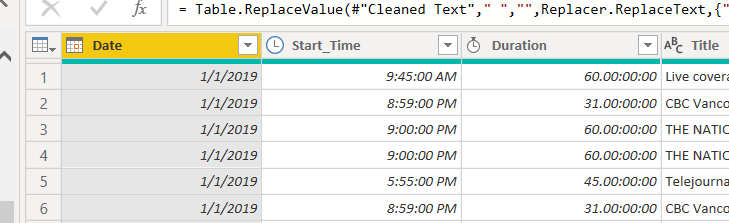

      However, I am not sure your duration column is correctly filled in PowerQuery.
      In PowerQuery, 60.00:00:00 means 60 days and not 60 minutes. A duration value is expressed in Days, Hours, Minutes and Seconds.
      You would have to make a conversion first.

      Thank you, Can you please explain how I can make the conversion for the duration column? Power Bi is so new to me. I thought if I just changed the data type to duration that would be okay? Can I correct something in here? If I try to change it to any other data type I get an error.Ā

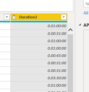

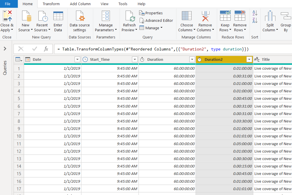

      I used a simple division in PowerQuery in a new column to convert to the Time format (in days & hour):Ā Ā
      = Table.AddColumn(#”LAST_STEP_NAME”, “Duration2”, each [Duration]/60/24)

      I did it…OMG, I’m so happy and I figured it out. I could never have done this without your help…Thank you, Thank you, Thank you.Ā
      Look at that. It’s correct.

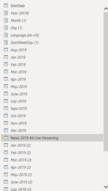

      After adding this new durations column to my file and click on Apply, it just keeps running and running the Applied changes forever and the file sizes are huge and it’s not even finished. I don’t know if it’s normal because I have Appended 12 files together with the old duration column and Appended /Merged files together to create one file and then on the new Appended file I did your formula. Should I add the new duration column to each monthly file and then do the Append. Wil that make a difference?
      I have unenabled the load on all the monthly files, except the New 2019 Live Stream which is all the monthly report Appended together so they wouldn’t load each time. I guess I’m not sure why adding the Duration2 column would create this issue? Should I remove the first Duration column or will that create a problem too?
