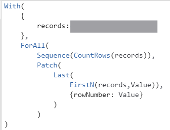

      Hi,Ā
      in my galleries i am using alternate row colors. I am using the following formula in the Gallery Items and within the Gallery i work with Mod.
      It works fine, but in some cases i want to patch a whole collection back to Dataverse.
      When i add this rowNumber column, the structure of the collection and datasource is different and i cannot patch it anymore.
      Do you have any other way to achieve an alternate row color without patching an additional rowNumber column?

      November 10, 2022 at 8:39 PM
      You could use DropColumns before you Patch.?
