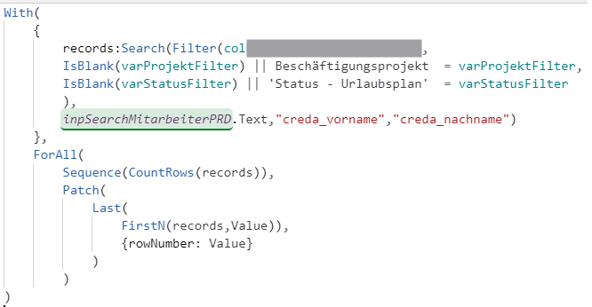

      I haveĀ  big gallery with 500 items.
      I collect them when loading the screen and use it in the Gallery Items.
      Within the gallery items, i have also 1 search field and 2 filter dropdowns.
      This is how it looks like.
      When filtering, the whole app stucks and sometimes it gets unresponsive.
      I think the problem is, that the gallery is showing all 500 items at the time.
      Is it possible to limit the shown items to 100 and when you scroll to the bottom it shows the next 100?

    • Warren Belz
      November 10, 2022 at 8:56 PM
      A couple of things – firstly please post your code in Text? as the below is OCRd so watch spelling.
      With(
            records:
            Filter(
               colxxxxxx,
                  IsBlank(varProjektFilter) ||
                  BeschƤftigungsprojekt = varProjektFilter
                  IsBlank(varStatusFilter) ||
                  'Status - Urlaubsplan' = varStatusFilter
                  Len(inpSearchMitarbeiterPRD.Text) = 0 ||
                  inpSearchMitarbeiterPRD.Text in creda_nachname
         ForAll(
            Sequence(CountRows(records)),
            Patch(
               Last(
                  FirstN(
                     records,
                     Value
               {rowNumber: Value}
      Also you are filtering on Variable rather than directly on the drop-downs, so there is another process before the filter starts. As well I have combined all the functions into a Filter rather than Search happening afterwards.
