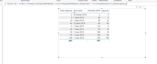

    • Rajat Jaiswal
      December 1, 2019 at 10:30 AM
      If I understand your problem correctly by attaching excel.
      You have to follow below steps
      1. Add 3 Columns Month, Year, Monthly Sum
      MONTHNumber = MONTH(Sheet1[from date])
      Year =Ā  Year( Sheet1[From Date])
      Monthly SUM = SUMX(FILTER(Sheet1,AND(Sheet1[MONTHNumber] =EARLIER(Sheet1[MONTHNumber]),Sheet1[Year] = EARLIER(Sheet1[Year]))),Sheet1[capacity])
      **Ā  Please, make sure you have sort your data by from dateĀ  see below snap for more detail
      Month wise sum
      Rajat Jaiswal
      Developer
      Indore
