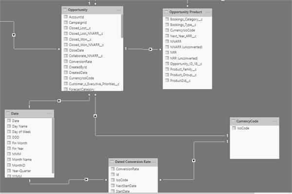

      CloseDate is located in the opportunity table; NNARR revenue is located in the opportunity product table and Startdate is the key to link opportunity table and date table.
      The date models between tables used:
      Ā Thanks!

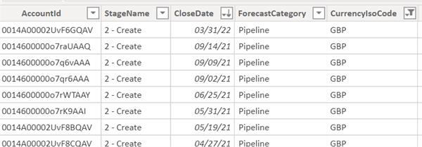

    • Min Su
      March 25, 2020 at 11:54 AM
      Hi Ashley,
      There is an actual date in the future power bi can look up.Ā
      Here is the opportunity table in which I would like to create a conversionRate calculated column.

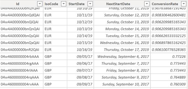

      Here is the dated conversion rate table that storages updated conversion rate information. In a single day, there are conversion rates for multiple currencies. Ā
