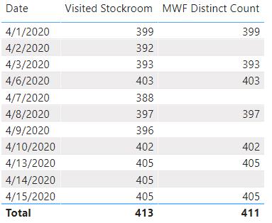

      Once you have these two columns you can use MWF as a filter in your distinct count measure
      MWF Distinct Count = CALCULATE(DISTINCTCOUNT(‘Daily Data'[Stockroom Name]),’Calendar'[MWF]=”YES”)

      Thanks for the formation ,,, i think its very close … but am using my measure in “cards” so based on date selection in slicer my measure output should change.
      in same card i like show alternative day selection output. andĀ i do not wantĀ  to show that in table format in my visual.
