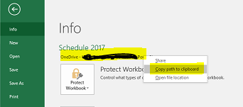

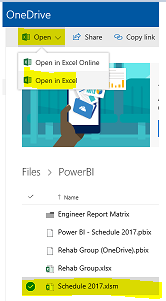

      • I assume you getting it by clicking share file in OneDrive
      The following will not work you have to open that file in Excel and copy the link from excel see steps below:
      1. Select file and OPEN with EXCEL

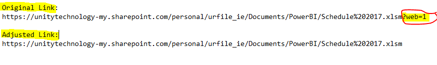

      2. Click FILE and under INFO just click on location path
      3. Delete last characters "?web=1"  then use that link to connect using WEB
      This should work for you!
