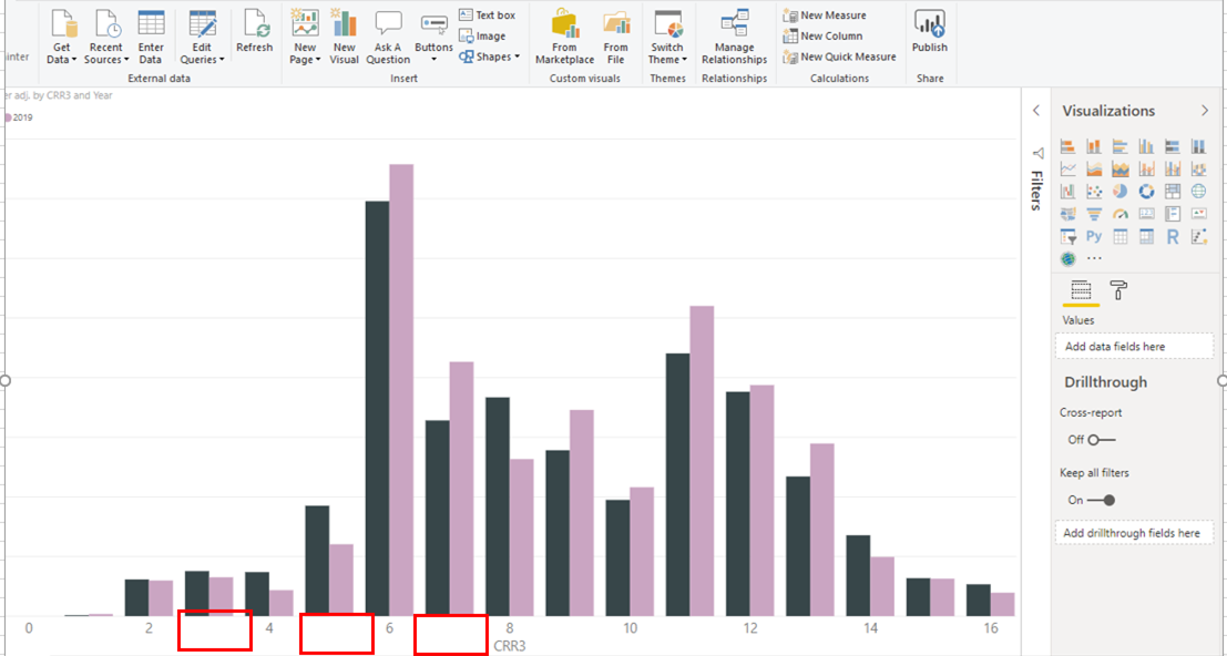

      Would like to display all the label 1, 2, 3, 4, 5……. instead of 2, 4, 6……
      Thank you.

      set X Axis Type as Categorical and not Continuous.
