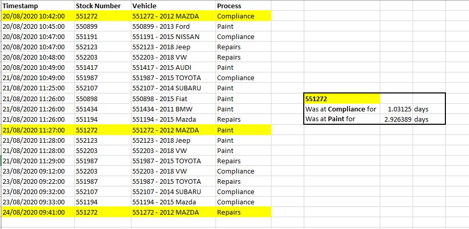

      I’m trying to find a way to calculate the time each vehicle spends at each process stage from the data provided.Ā
      When the process stage changes, it triggers the end of the time of the previous process… e.g.Ā
      Sample doc with the data is attached.
      Any help would be much appreciated šŸ™‚

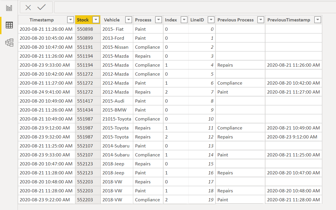

    • Jonathan Perry
      September 8, 2020 at 6:53 PM
      Thank you and for your help with this problem. I was able to use parts of both of your responses to get the outcome I needed. Much appreciated!??
