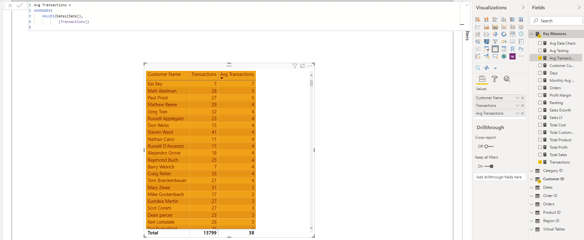

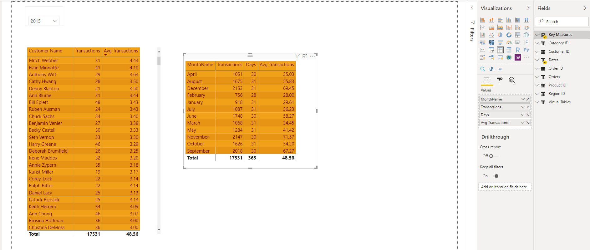

      I think key thing with this is your need to iterate. Thats the key thing to bear in mind as you want to average over the Dates Tables.and the natural filtering logic to run over the months.Ā
      Similar example to what your wantĀ
      See below my example:
      -Transactions:
      =COUNTROWS(Orders)
      -Avg TransactionsĀ  Ā  Ā  Ā  Ā  Ā  Ā  Ā
      =AVERAGEX(
      Ā VALUES(Dates[Date]),
      Ā  Ā  Ā  Ā  Ā [Transactions])
      Hope this helpsĀ
