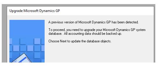

      Trying to install the Year end Update
      Ā After running “MicrosoftDynamicsGP18-KB4602593-ENU.msp”. it completes just fine.
      Ā I run “GP Utilities” and it sees a previous version and wants to proceed with the upgrade.
      It does the upgrade to the DYNAMICS DB but when its tries to do the company DB’s I get the waring that I am trying to install an older version and it won’t go any farer.
      I checked the upgrade table, and it shows that the DYNAMICS database has been upgraded to the correct version and it shows all the company databases on the older version.
      Ā Select * from DYNAMICS..DB_Upgrade where PRODID=0
      Ā Company1Ā Ā Ā Ā Ā Ā Ā Ā Ā  Ā Ā Ā Ā Ā Ā Ā Ā Ā Ā Ā Ā Ā Ā  0Ā Ā Ā Ā Ā Ā Ā Ā Ā Ā Ā Ā Ā  18Ā Ā Ā Ā Ā Ā Ā Ā Ā Ā  4Ā Ā Ā Ā Ā Ā Ā Ā Ā Ā Ā Ā Ā  1384Ā Ā Ā Ā Ā Ā  18Ā Ā Ā Ā Ā Ā Ā Ā Ā Ā  4Ā Ā Ā Ā Ā Ā Ā Ā Ā Ā Ā Ā Ā  1384
      DYNAMICSĀ Ā Ā Ā Ā Ā Ā Ā Ā Ā Ā Ā Ā Ā Ā Ā Ā Ā Ā Ā Ā  Ā  0Ā Ā Ā Ā Ā Ā Ā Ā Ā Ā Ā Ā Ā  18Ā Ā Ā Ā Ā Ā Ā Ā Ā Ā  5Ā Ā Ā Ā Ā Ā Ā Ā Ā Ā Ā Ā Ā  1596Ā Ā Ā Ā Ā Ā  18Ā Ā Ā Ā Ā Ā Ā Ā Ā Ā  5Ā Ā Ā Ā Ā Ā Ā Ā Ā Ā Ā Ā Ā  1596
      No clue on what my next steps would be?

      Yes this is on my test system that is virtual.Ā  Ā I reverted it back to before anything was done. Ā Ā I ran the “MicrosoftDynamicsGP18-KB4602589-ENU.msp” it completes just fine. Ā I run “GP Utilities” and it sees a previous version and wants to proceed with the upgrade. It does the upgrade to the DYNAMICS DB but when its tries to do the company DB’s I get the waring that I am trying to install an older version and it won’t go any farer again.
      db_nameĀ Ā Ā Ā Ā Ā Ā Ā Ā Ā Ā  PRODIDĀ  Ā  Ā  Ā  Ā  Ā  Ā  Ā db_verMajorĀ Ā Ā Ā  db_verMinorĀ Ā Ā Ā  db_verBuildĀ Ā Ā Ā Ā Ā  db_verOldMajorĀ Ā Ā Ā Ā Ā Ā Ā Ā Ā Ā Ā Ā Ā Ā  db_verOldMinorĀ Ā Ā Ā Ā Ā Ā Ā Ā Ā Ā Ā Ā  db_verOldBuild Ā Ā Ā Ā Ā Ā Ā Ā Ā Ā Ā Ā Ā Ā Ā  db_status
      DYNAMICSĀ  Ā  Ā  Ā  Ā  Ā  0Ā Ā Ā Ā Ā Ā Ā Ā Ā Ā Ā Ā Ā  Ā Ā Ā Ā Ā Ā Ā Ā Ā Ā Ā Ā Ā Ā Ā  18Ā Ā Ā Ā Ā Ā Ā Ā Ā Ā  Ā Ā Ā Ā Ā Ā Ā Ā Ā Ā Ā Ā Ā Ā Ā  5Ā Ā Ā Ā Ā Ā Ā Ā Ā Ā Ā Ā Ā  1556Ā  Ā  Ā  Ā  Ā  Ā  Ā  Ā  Ā  Ā  Ā  Ā  18Ā Ā Ā Ā Ā Ā Ā Ā Ā Ā  Ā Ā Ā Ā Ā Ā Ā Ā Ā Ā Ā Ā Ā Ā Ā Ā Ā Ā Ā Ā Ā Ā Ā Ā Ā Ā Ā Ā Ā Ā Ā  5Ā  Ā  Ā  Ā  Ā  Ā  Ā  Ā  Ā  Ā  Ā  Ā  Ā  Ā  Ā  Ā  Ā  Ā  Ā  1556Ā  Ā  Ā  Ā  Ā  Ā  Ā  Ā  Ā  Ā  Ā  Ā  Ā  0
      Company1Ā  Ā  Ā  Ā  Ā  Ā  Ā 0Ā Ā Ā Ā Ā Ā Ā Ā Ā Ā Ā Ā Ā  Ā Ā Ā Ā Ā Ā Ā Ā Ā Ā Ā Ā Ā Ā Ā  18Ā Ā Ā Ā Ā Ā Ā Ā Ā Ā  Ā Ā Ā Ā Ā Ā Ā Ā Ā Ā Ā Ā Ā Ā Ā  4Ā Ā Ā Ā Ā Ā Ā Ā Ā Ā Ā Ā Ā  1384Ā  Ā  Ā  Ā  Ā  Ā  Ā  Ā  Ā  Ā  Ā  Ā  Ā 18Ā Ā Ā Ā Ā Ā Ā Ā Ā Ā  Ā Ā Ā Ā Ā Ā Ā Ā Ā Ā Ā Ā Ā Ā Ā Ā Ā Ā Ā Ā Ā Ā Ā Ā Ā Ā Ā Ā Ā Ā Ā  4Ā  Ā  Ā  Ā  Ā  Ā  Ā  Ā  Ā  Ā  Ā  Ā  Ā  Ā  Ā  Ā  Ā  Ā  Ā 1384Ā  Ā  Ā  Ā  Ā  Ā  Ā  Ā  Ā  Ā  Ā  Ā  Ā  Ā 0
      I reverted it again and ran check links on all companies for the System and Company series and then did the upgrade again with the same results.Ā
      Any other suggestions?
