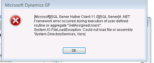

      When submitting an A/P Batch Approval Work Flow we got the following error:
      We had it working a while back, but had turnover and was put on the back burner.
      Can anybody tell me what we did wrong?Ā

      Try running this script against your DYNAMICS/system database for GP:
      Ā  Ā  Ā  EXEC wfDeployClrAssemblies
      Normally, this will resolve that error message when submitting/trying to take action on a workflow.

      Thank you Derek.Ā  That worked!!
