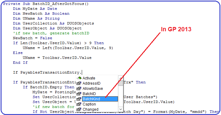

      Yes I know all about VBA, and alternate coding is planned. After the GP 2018 R2 upgrade.
      I did run across an issue with one command option going missing in GP 2018R2
      If PayablesTransactionEntry.BatchKind = “New Trx” Then
      Is this possibly an older library issue or what?Ā

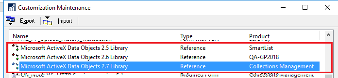

      These references exist both in the GP 2013 12.00.1538 and GP 2018 R2 18.00.0727 (R2)
      Ideas?

    • David Musgrave
      October 18, 2022 at 3:36 AM
      Hi David
      Never seen a BatchKind field before. Is that an alternate window?
      Look at Display Existing Record if you want to know if this is a new batch or existing batch.
      Time to replace VBA with GP Power Tools. ??

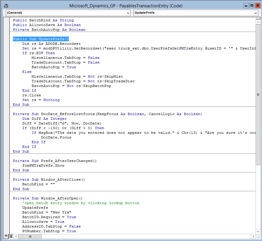

    • David Morinello
      October 18, 2022 at 10:56 AM
      I found the problem in a missing UpdatePrefs bit of code that was not ported to the GP 2018 instance. No more error.
      Recoding away from VBA will happen, after the update, when more time frees up.
