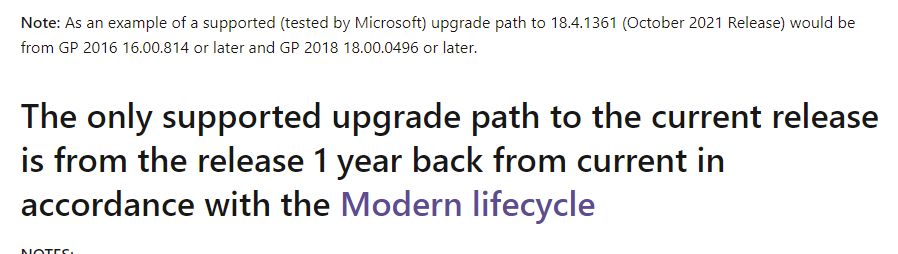

      The upgrades went well. Definitely look at the upgrade blogs for known issues as this will save a lot of time and headaches. Since getting customers to the modern lifecycle, we look to complete one upgrade a year to keep them up to date (supported).Ā  I am not sure if you saw this site or not but if not, it may prove to be useful.
      https://docs.microsoft.com/en-us/dynamics/s-e/gp/hot_topic_mdgpupgrade_415
      There is a ?note and some really big font (shouting that I am important information not to be missed ;)).Ā  I have added a screenshot below so you can simply see the information. Based on the notes, it would seem to me that you could go from 2018 R2 to the December release but it never calls it out that you can (because you can go from GP 2018 to the October 2021 release). At the very least, you know for sure that you can go to 18.4.1361.Ā  Ā
      Sorry if this doesn’t quite answer your question. Microsoft has proven yet again that ambiguity is acceptable within documentation. šŸ™Ā
