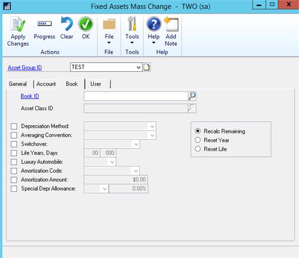

      Have you tested the Mass Change option? You can import the list of assets to change into a group and then use the group to do the mass change.Ā
