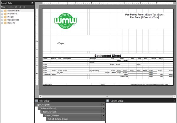

I’m not sure which screenshots would be helpful – when I first open to edit in Microsoft SQL Server Report Builder, I see this:

Hi Vanessa,
It can be quite difficult to find out if the text box is hidden by a formula, a table row, or some other item.Ā From you SSRS editor, you should be able to save the report a RDL file to your local hard drive.Ā The RDL file is xml formatted text file.Ā You can open it in notepad and search for stuff – show, hide, visible, hidden.Ā This may help you find out what object is being hidden.
Good Luck!

I’ll try that, thanks!?

Haha. I do have and love Notepad++ for many years, so whenĀ said “notepad” I mentally adjusted to “notepad++” and opened the file in that program accordingly. (See, I said I wasn’t completely in the dark!) ?
