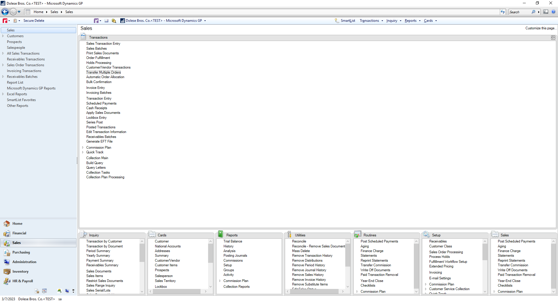

      This use to be in GP2013, we are now on GP 2018R2 and would like to know where this function is now?

      Where in GP do I go do this.  In gp2013 it was under sales -> sales transactions.   I do not see this there in GP2018

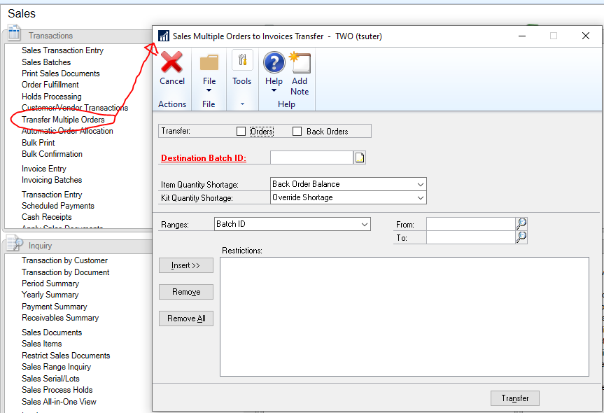

      That feature is part of the Advanced Distribution suite.Ā  Go to Setup System Registration and make sure the Advanced Distribution suite checkbox is marked. If it is marked, then unmark and remark it as sa. That should do it. Unless it is not part of your registration keys.
      Marking should expose the pallette choices and the window if you are registered in GP2018.

      That did it, Thanks
