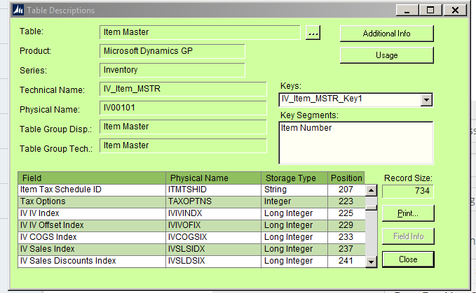

      The inventory master table (IV00101) contains the accounts associated with an item.
      Look at the field IVSLSIDX to get the sales account index for that item.  You can then link that index to the GL00100 or GL00105 to get the full account number or account description.

      Thank you – that looks like just what I needed!
