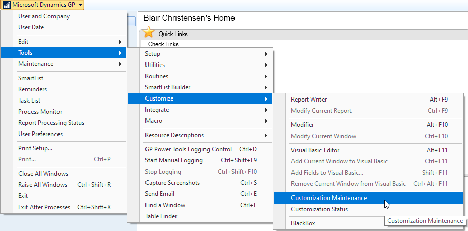

      The first thing you probably want to do is check to see if you are using a stock invoice form or a customized one.Ā  You can do that by accessing the Customization Maintenance Window:
      Navigation to the Customization Maintenance Window

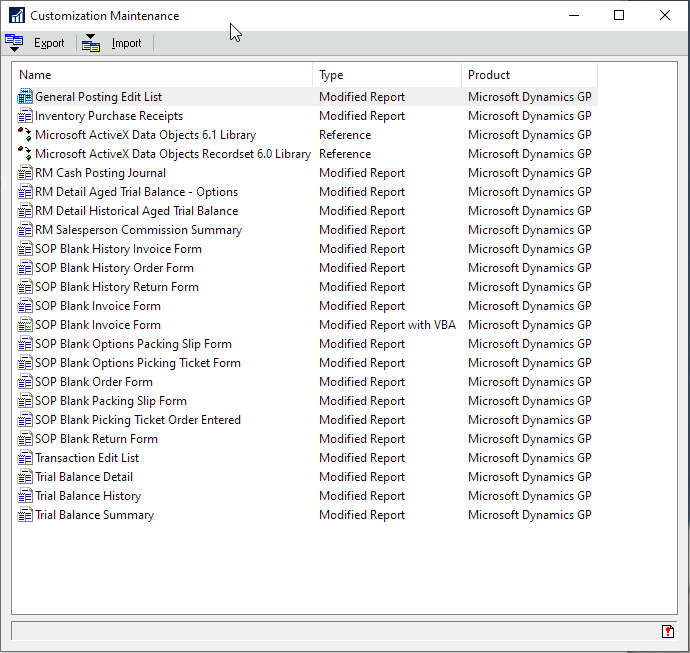

      From there you can see which of your documents have been modified from the originals.
      Once you know which ones are modified you can further troubleshoot.Ā  Note that there are usually two versions of each printable form: a “basic” form and a History form.Ā  They are used at different times in the process which can be a little confusing to some.Ā  The “basic” form is used PRIOR to posting while the History form is used AFTER posting.Ā  So you could be having problems with your basic form while the History version is fine.Ā  (I’ve had this problem on my side as well.)
