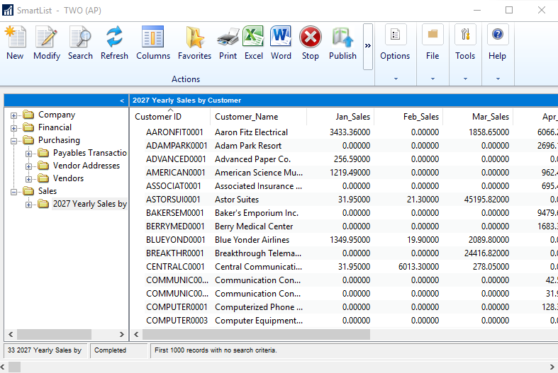

      I am working on some final edits for #GPUGAmplify! I am documenting how to publish SmartList Designer reports. I cannot find information about the security needed for Publish to be enabled. (I mean the Publish button that creates the Excel Report).
      **Note: I am not talking about SmartList Builder. I know the rule for that product. I am talking about the GP built in SmartList Designer product**
      I am running GP in test so it’s tough to figure out if I updated my SQL security years ago. It worked for me when logged in as ‘sa’ and as a generic user with the AP CLERK security role. I have a feeling it is a SQL setting…I just can’t find the info to make sure I am correct when I document this for my GP Tip.

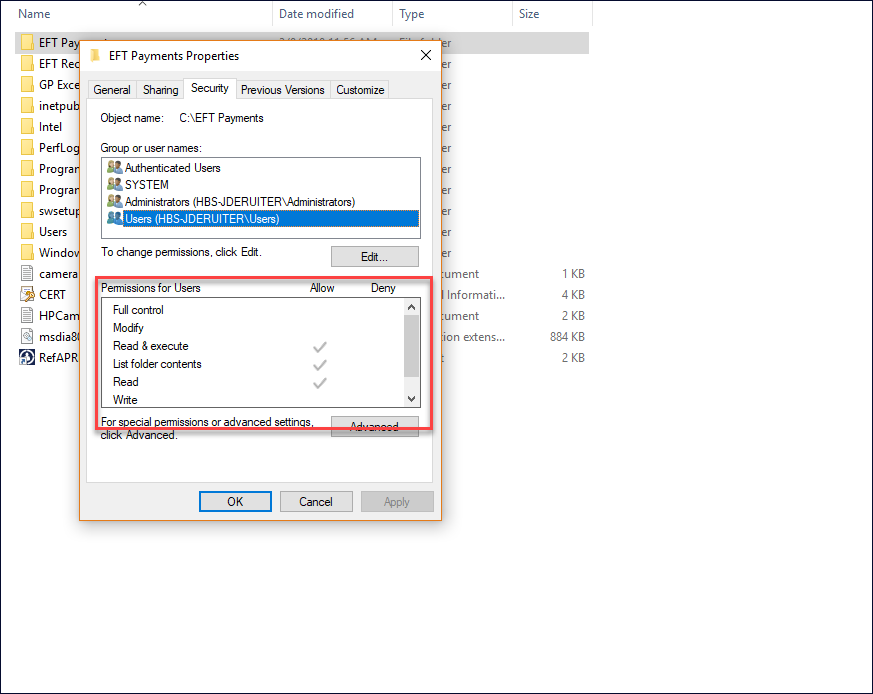

      I would assume the ability to Publish might have to do with the AD Securities… like can you write to a certain file location, maybe a combination of each.
      Can the AP CLERK publish a payroll report?
      Anyway, look at the file location permissions.Ā  You may have to reduce permissions on shared locations to limit user’s abilities to publish.

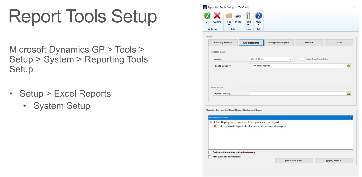

      I’m glad you asked this.Ā  I’m actually covering this in my Amplify session.Ā  Hope this helps.Ā  If you haven’t already deployed the reports then you can click deploy report in the bottom right once you have your reports dictionary path in place.Ā  Once you have this setup log out and back into GP and you will then see the Publish button is activated in SmartList.Ā

      2.Ā Ā Ā Ā  The user who is attempting to publish must have ReadWriteModify permissions to the share location where the Excel reports are deployed to.
      3.Ā Ā Ā Ā  The default Excel reports must be deployed already.
