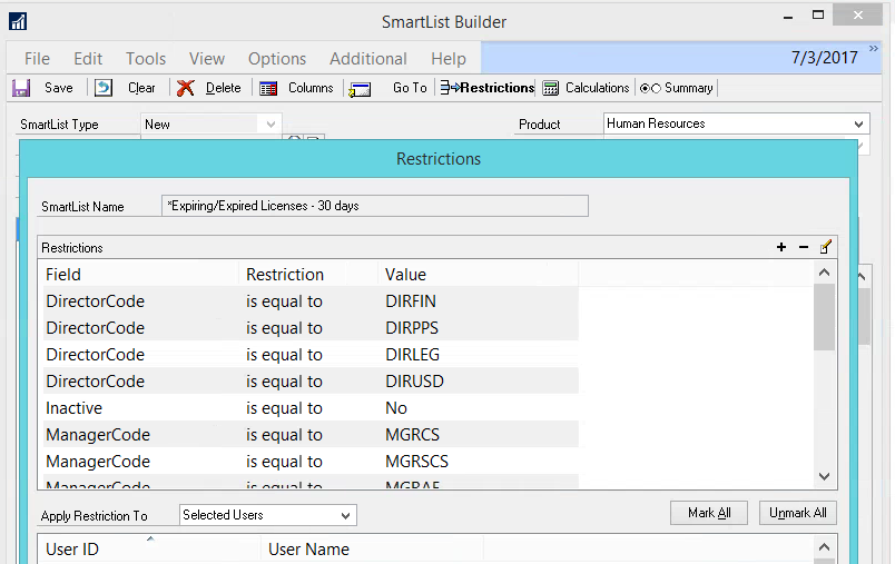

      Have any user-specific restrictions been set up in the Smartlist itself?

      ?What do you mean by user-restrictions to the Smartlist?.
      There are 5 users that are in the CS-01 role, the CS-01 role has a number of tasks. Under user security each of the 5 users are assigned the same role/tasks.
      3 of the 5 users have no problem with the Smartlist in question while the others do have an issue.
