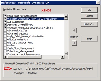

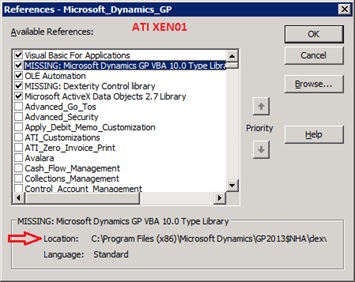

      2. On 3 Servers the “ATI” client work fine, on the 4th it says it is missing libraries. Users accessing the form get screens similar to below.
      3. All 4 have the same shared location for the Forms.dic file in each of the 4 Dynamics.set files

      2 Bad “Missing” references and pointing to an incorrect folder for the libraries.
      Good references and all are pointing to the correct folder for the libraries.

      I noticed that your 2 screenshots are actually showing 2 different VBA references.. one for v12 and one v10 !?!..
      VBA reference files are usually DLL’s and those need to be registered in Windows before they can be used as references..
      Check out some discussions on internet about registering DLL files. ?Here’s an example :Ā
      http://www.cpearson.com/excel/missingreferences.aspx
      Though quite an old blog post, it’s still valid today.

      The problem is with the one Citrix Server with the Missing Microsoft Dynamics VBA 10.0 Type Library (tlb not DLL), as well as the Dexterity Control Library (also a tlb file) showing as Missing.
      The other 3 working Citrix Servers, using the same Forms dictionary, show the VBA Microsoft Dynamics VBA 12.00 Type Library and Dexterity Control Library. Users accessing the same form on these 3 are working fine.
