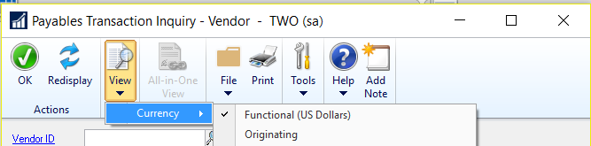

      Since yours is happen at the apply stage I would go back into inquiry on the transactions in that date range and see if by some chance someone accidentally chose a different currency and didn’t realize it.Ā  In the inquiry window you should be able to toggle between currencies (if there are differences)
