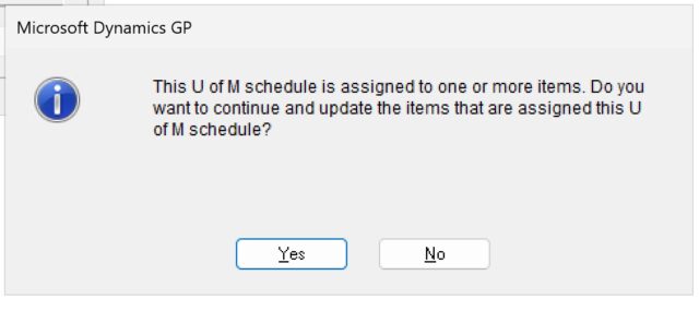

    When you add the new UofM it should ask you if you want to roll it down…

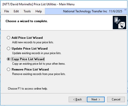

      I ended up reacquainting myself with the (Price List Utilities) Copy Price List Wizard, to give that team what they needed.
