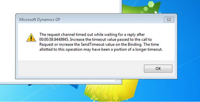

      Has anyone seen this error?Ā  A user received this error when logging in on a virtual desktop (VMWare).Ā Ā

      IT may have been doing maintenance on VMWare. Ā  We’ve seen these errors when the host of the virtual desktops is having a difficult time responding because something else is going on in the background, i.e. the server is being moved to a different storage pool. Ā
      I would recommend checking with them to see if they were doing any maintenance. Ā If it’s persistent reset the users session, or restart the host entirely.

      ThanksĀ  – they were not doing maintenance, but did restart the host.Ā  We’ve been having a variety of issues lately and it seems to be a new error daily.Ā  Never a dull moment!
