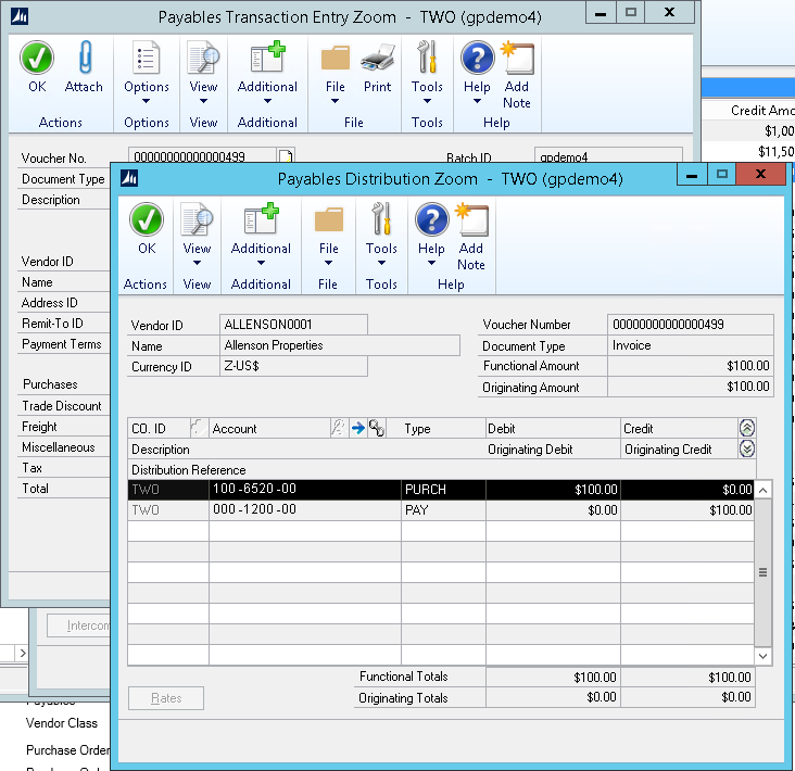

      Finally, is it possible any transactions were posted to a different account than your A/P control account? This would be where someone inadvertently changed the posting account on the PAYables entry to an account other than your AP control account (below I changed the account to 000-1200-00 which is my AR Control Account):

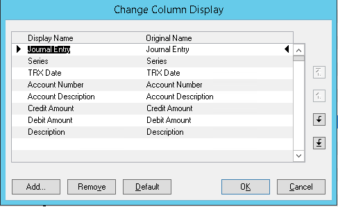

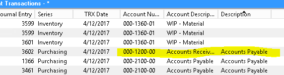

      In Smartlist, run Financial – Account Transactions, search on the current period and the Purchasing Series, add Description to the Smartlist,
      Sort by description and look for Account Description and Account Number not equal to your control account for any Accounts Payable entries:
      Once the payment is made on this invoice, the entry will clear this account and your Trial Balance will be back in balance. But until then, your control account will be less than your Historical Trial Balance.
      These items should show up as unmatched in the Reconcile to GL report however. So if you fully clear the unmatched items this should not be your problem.
