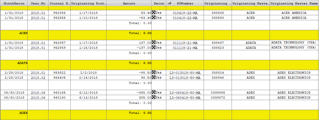

      We just converted from GP2010 to GP2015.Ā  When I started in 2014, the Accrued A/P had not been reconciled since 5/2012.Ā Ā
      Back then, I pulled a number of smartlists to get all of the fields of data.Ā  Purchase Orders were not closed properly, ever.Ā  If something was received and NEVER invoiced, the amount was written off directly, not clearing the receiving in Great Plains.Ā Ā
      Now, I use an ODBC connection to get the GL transactions for the month, with links to get the related purchase order numbers on each transaction.Ā  I sort by Purchase Order Number.Ā  I can see if there are any uncleared items.
      Since it is under control, I can reconcile it in about 20 minutes.Ā  The process can be done in Excel, I just do not know VBA programming to automate as it is in this tool.Ā Ā

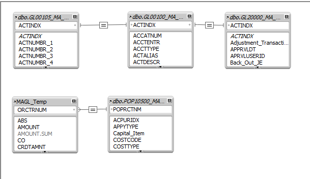

      These are the tables in GP I am using.Ā  The “_MA” appended is to make it clear to me, which of our four companies I am referencing.Ā  The MAGL_Temp is a temporary table.Ā  In dbo.GL20000 I search for the records for the accrue payables for the current month.Ā  Then I import them into the temporary table.Ā  As they are imported a lookup is make from dbo.POP10500 to append the purchase order number.Ā Ā
      I am not an SQL expert.Ā  This could probably be done through SQL code and dumped in Excel.Ā  I use a database program (FileMaker Pro) to handle the work for me.Ā Ā
