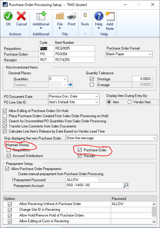

    • Thaddeus Suter
      August 13, 2021 at 9:49 AM
      If you are maintaining Purchase Order history (see PO Processing Setup below), a Closed PO can be reopened normally until it has been removed to History at which time it can no longer be reopened from History. This is a core feature.
      If you are not maintaining PO History (no check mark), a PO can be reopened normally only until it is removed from the system.
