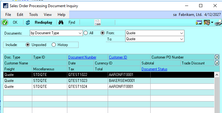

      In GP, check in Inquiry how many different Sales Quotes you may have:Ā
      You may check that in SOP Setup too, but this is quick and easy.Ā

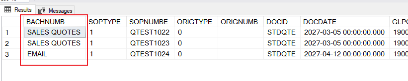

      Once you figured that out, run a query in SQL against the SOP10100 table and get all the documents that are open (SOP10100) with the DOCID matching your Sales Quote ID.
      select BACHNUMB,* from SOP10100
      where DOCID like ‘STDQTE’
      The result will show you if those documents are already assigned to a batch or not.
      With this information on hand you then assign all the Sales Quotes to a single Sales Batch (existing one or a newly created one for that purpose) by using this script:
      UPDATE SOP10100
      set BACHNUMB = ‘SALES QUOTES’
      WHERE DOCID = ‘STDQTE’
      Once you have them all under a single Batch, you just go in GP, select the batch and delete it. That will get rid of all the related Sales Quotes.
