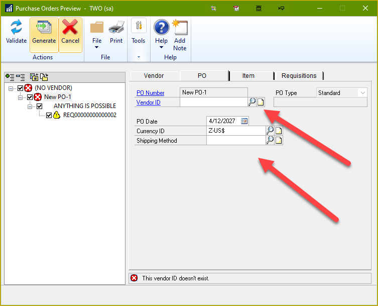

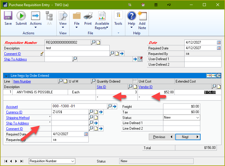

      September 16, 2020 at 8:33 AM
      You CAN create and approve Requisitions BEFORE you input the vendor, anything on the requisition that has an asterisk can be filled in later.
      During the transfer to PO once approved, you can select the vendor then, giving you time to get a new vendor approved or have the accounting team choose the vendor:
      The ITEM must exist already, but if you are not ‘really’ using inventory you can set GP up to just type in anything you want there as a ‘non inventory’ item.
      If you are using Inventory and need what is being purchased to become inventory, they you would have to set the ITEM up first.
      And, as a tip, though you CAN leave the ‘ship to’ field blank, it is a pain in the ‘you know what’ to alter each line after the PO is created to input the ship-to address, so I’d make sure that got filled out before transferring to a PO.
