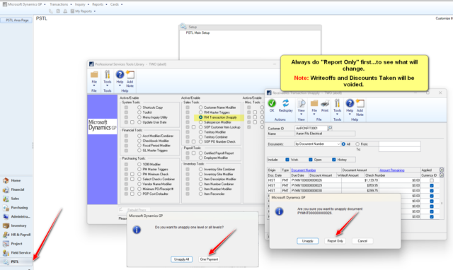

    I believe there is a tool in the Professional Services Tools Library (PSTL pronounced Pistol) that can return a transaction from history to open.
    PSTL can be installed from the Dynamics GP DVD image as a dictionary module.
    Hope this helps
    Regards
    David
  • Amber Bell
    March 19, 2025 at 1:35 pm
    Hello Calvin,
    David is correct. I am sending a screenshot to show how to access. If you don’t have PSTL installed, reach out to your partner. It is free.
