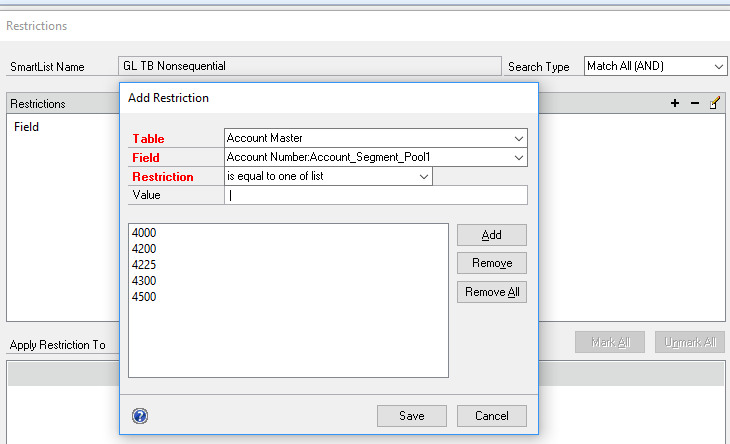

      Well certainly it is easily done in Management Reporter with a Row Format.
      If you were asking for Smartlist that would be done by building a List Restriction in Smartlist Builder where you pick the values for the Segment Pool that you want to report, and don’tĀ  pick the others.
      See example below where I selected five values in Segment 1:

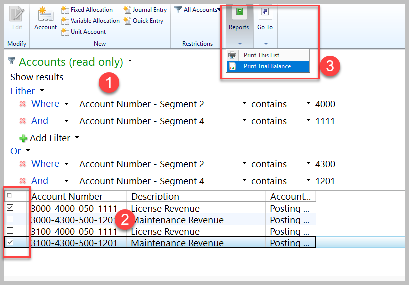

      If it’s a regular GP Trial Balance you’re looking for, you can accomplish this with Navigation Lists – here’s how:
      1. Open the Financial Area page and click on Accounts in the Navigation Pane to generate your list of GL accounts:
      GP Navigation Pane window

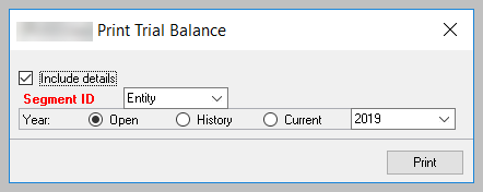

      2. Create filters if needed (1 below), mark the accounts you want included in your trial balance (2 below), click on reports and choose ‘Print Trial Balance’ (3 below and following image).
      GP Navigation List Area
      GP Print TB window
      Note that you can only choose summary or detail and the year, not a range of periods.

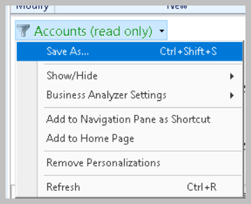

      You can also save the filtered list you created by clicking on the ‘Accounts (read only)’ menu and choosing a name for the list view so you can re-use it later:
      GP Navigation New ListĀ
      Hope this gives you another option!

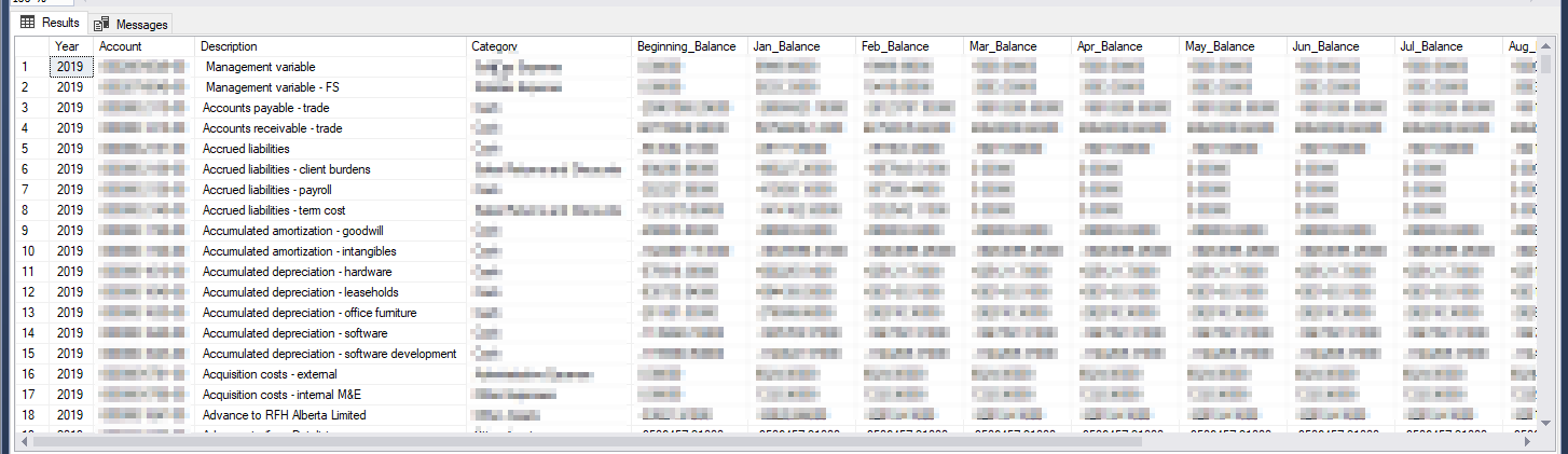

    • George Kuntz, MSc
      October 26, 2018 at 11:52 AM
      See below. Sorry it took me a while, it has been a bit crazy here.Ā  Enjoy!
