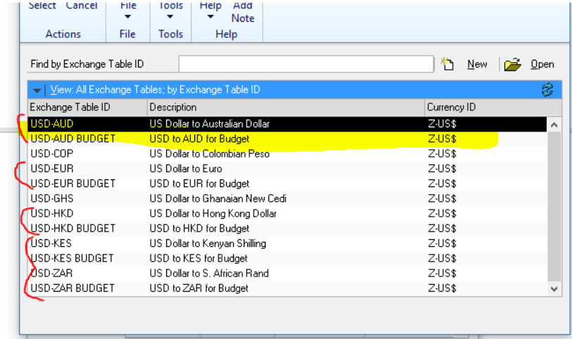

      ?This is how we are set up:
      We have two tables set up for each currency, the budget table and the daily table. The budget rate is fixed for the entire year so there is only 1 rate that budget columns are calculated from. All other reports use the daily rate table. If the report is run today it will recalculate the entire year at the 9/14/17 exchange rate in the tables.
      Since we don’t have an Average table set up, could that be why our reports come up with these differences?

    • Beat Bucher
      September 15, 2017 at 11:44 AM
      Absolutely.
      If you read the KB article I posted the reference for, you’ll see that Microsoft talks about the Average and Month-end rates too..
      As a suggestion, your screenshot shows the Z-US$ currency.. which is one the demo currencies that come with GP by default (because used by the Fabrikam Inc/TWO company), but you shoudl definitely setup your own currency and use the ISO official shortnames for them.. (all the ones starting with ‘Z-‘ are demo currencies).
      Our company deals with 8 different currencies accross all our branches, and we have something like 45 Exchange tabled ID entries.. about 4-5 per currency (it varries by the pairs that we need to deal with).
