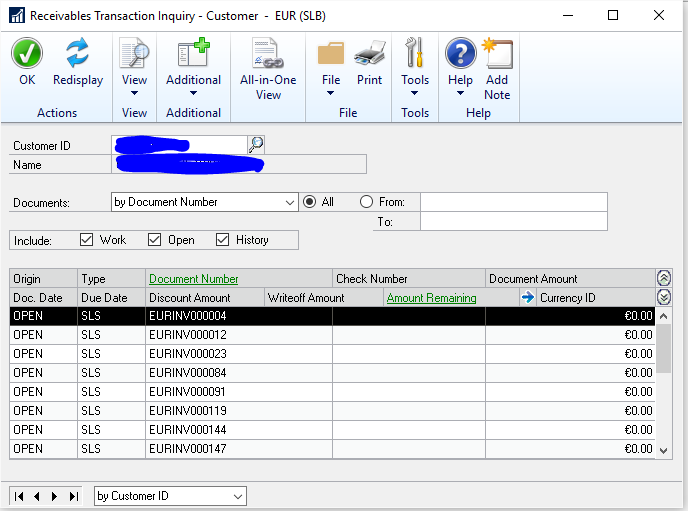

    • Shari Bruno
      January 8, 2019 at 4:36 PM
      ?Hi
      This is how all of the customers in all of our divisional companies look – the date on the first invoice listed is 2014:
      I went to the GP Housekeeping session at Summit and removing paid sales transactions was brought up. But I think I need to look into this routine further – and why our division companies have all these open sales invoices.
      Thanks for your help!?

    • Christine Boisvert
      January 8, 2019 at 4:24 PM
      Good afternoon Shari,Ā
      There is a difference between Receivables transactions and Sales Order Processing transactions. Sales Order Processing Quotes and Orders automatically move to history when they are transferred to an invoice. Once the Sales Order Processing invoice is posted, it moves to the Sales History table. When posting a Sales Order Processing invoice, behind the scenes, it also creates a Receivables transaction in the RMXXXX tables. Those RM transactions do remain in the Open table until you run the “Paid Transaction Removal” process off the Utilities area in the Sales home page. The advantage of removing those receivables transactions to history is that when you open certain inquiry screen, you can uncheck the include “history” section which makes the query run faster. Also, once transactions are moved in to history they will no longer appear on the customers’ statement. Keep in mind you cannot void an invoice that has been moved to history. If you plan on running the Paid Transaction Removal process, since you have never ran it, I would run it on a weekend or try one year at a time in a test company first. This process can take some time to run. You could also try running it for one customer and see what happens in the inquiry screen, the apply cash receipt screen etc…
