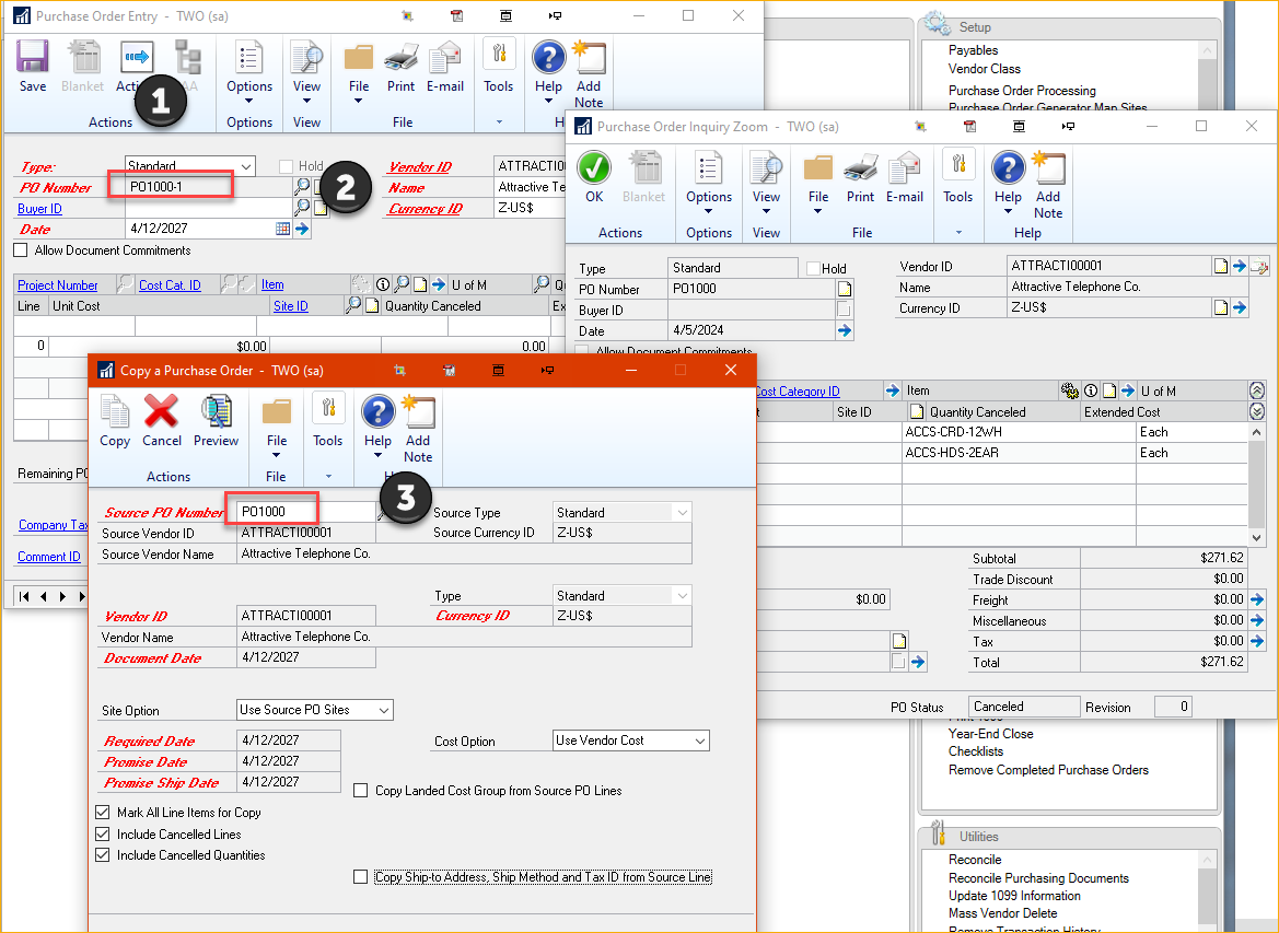

      We need to reopen some POs (put into status=change order; add some new lines; etc.)
      Can this be done? Move a PO from ‘History’ back to an ‘Open’ status?

      Hey!Ā  Haven’t talked to you in a while!
      There is no way, I know of, to move PO’s back from history.
      HOWEVER!Ā  thinking outside the box, you can use the “Copy PO” Functionality to copy the line information from old PO’s to a new one?, then change the PO Number.Ā  (Copy PO’s from the “Activity” Drop down.Ā  Just have to fill out the header of the PO before you use the Copy functionality
