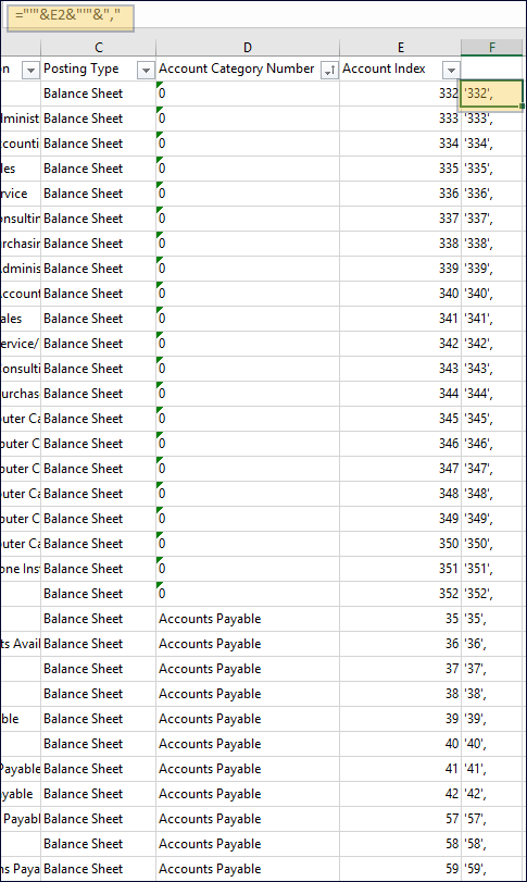

      ?Ā has given you a great method.Ā  However, I wanted to share with you my technique for writing the complex scenarios – I use Excel and then copy and paste my script into SQL.

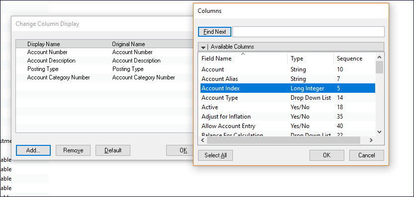

      I would download a SmartList of Accounts after you’ve added the Account Index to the SmartList – I’d also recommend filtering this as much as possible to save needing to delete the accounts you want to keep.
      Then run this out to Excel and add some code to create your SQL Script:

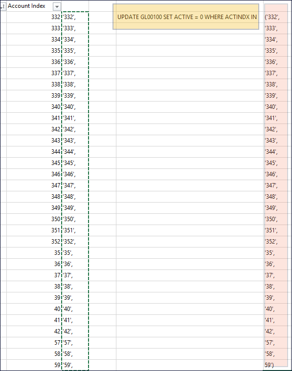

      Then create the script in Excel like this

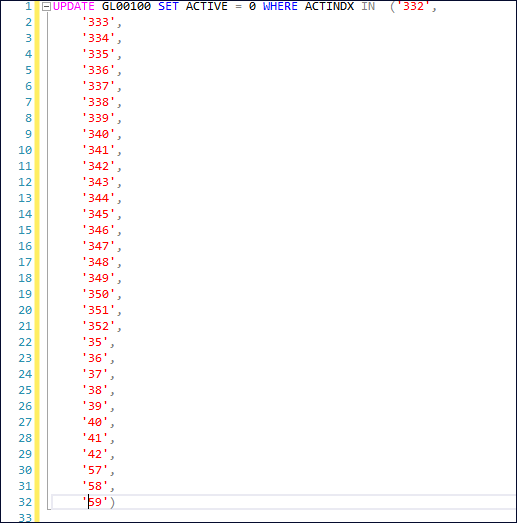

      Copy and paste the values from the account index concatenation – be sure to add an open parenthesis on the fist row and to add a closed parenthesis on the last row.
      Then just copy and paste this into SQL and run it.Ā  *Do as Shawn says and get a great backup of either the database or the table – or both before running this*

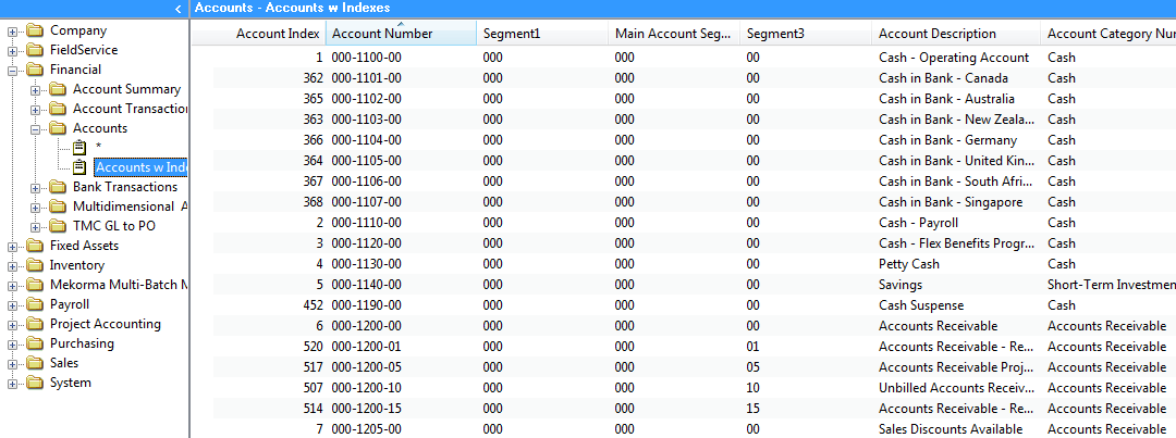

      You need to get the accounts you want to inactivate into Excel with two columns: one being the account number (called account string) and the other being the account index.
      See Smartlist below:

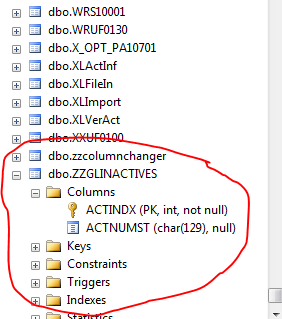

      Now have Kevin or Sean create a two column SQL table in the database like I show below. Mine is called ZZGLINACTIVES and use the SQL Excel wizard to load up your thousands of accounts from Excel into this new table with these two columns. ACTINDX and ACTNUMST Assign DYNGRP permsissions.
