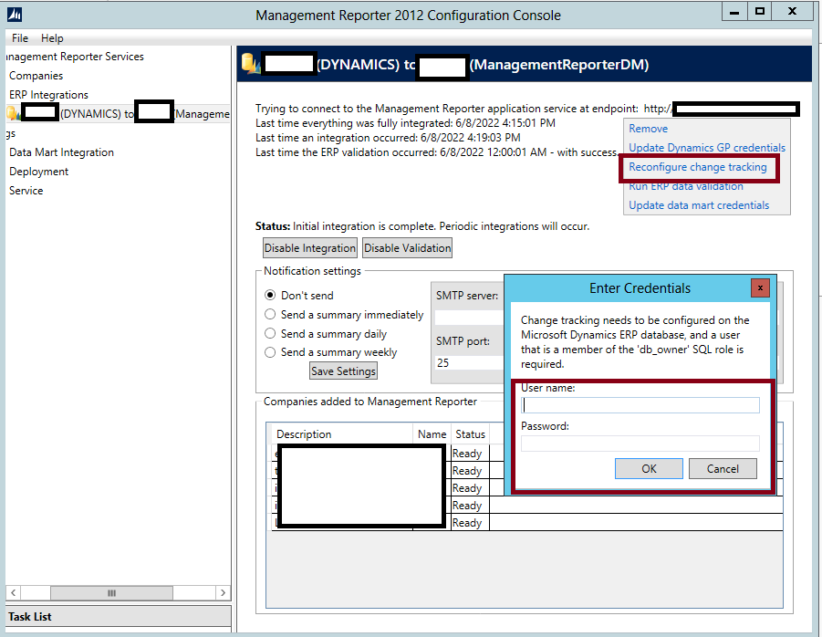

    • Steve Fryman
      June 8, 2022 at 4:26 PM
      The only time I’ve seen MR take that long is when you don’t reset the change tracking.Ā  Try the option to Reconfigure Change Tracking and see if that speeds up your process.Ā  I have a client with 100+ company databases and the data mart takes less than an hour to be rebuilt.Ā Ā
