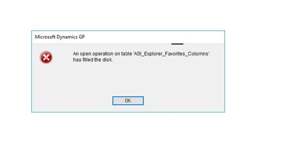

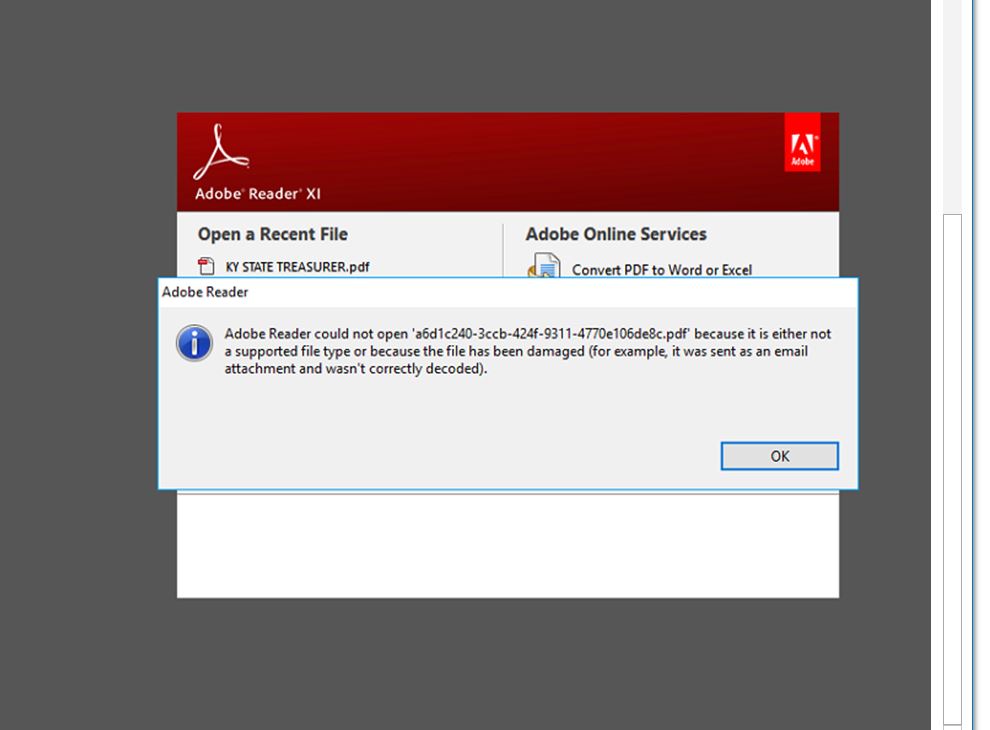

      I have a single staff who is experiencing and issue previewing attached documents in “Purch-Inquiry-transaction by vendor”.Ā  She can attach the document here and everyone else can preview it but she gets the attached Adobe error when trying to preview.Ā  I have verified it is not permissions (this was working two days a go) by assigning her Power User access to test and received the same result.Ā  When she exits the system after these steps she get the other error I have attached.Ā  I have uninstalled and reinstalled Adobe as well.

      Hi Dave,
      Is this on a local workstation?
      Can you maybe try clearing theĀ %TEMP% folder and see if it helps?
      I’ve encountered something similar, and found that clearing the user’s temp folder helpful.

    • Matthew Arp
      November 8, 2019 at 8:57 AM
      Also, make sure there is sufficient free disk space on the server.
