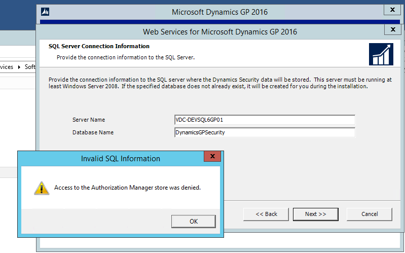

      I am in the process of upgrading to GP 2016R2 on new servers.  Web Services is giving me a hard time.  I haven’t been able to find any good documentation but here is what I’m trying:
      1.) Install Web Services.  My domain account is a local admin to the server and also a sysadmin in SQL.
      2.) I’m selecting to store the security data on SQL Server (Recommended).
      3.) Database name i’m specifying is ‘DynamicsGPSecurity’.
      4.) I get the error:  Invalid SQL Information: Access to the Authorization Manager store was denied.
      Any ideas?  I’ve tried copying my GP2015 ‘DynamicsGPSecurity’ db but this didn’t help…..not sure if this is to be upgraded or just recreated.  I don’t think there is any data I need in that db so a recreated/refreshed db would work.  Thanks in advance.

    • Jason Headrick
      January 26, 2017 at 5:22 PM
      I’ve tried it both ways…..same error.  With SQL auth I am using ‘sa’ and confirmed the password i’m using is correct.

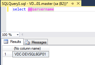

    • Ken Allgood
      January 27, 2017 at 8:09 AM
      You’re absolutely sure that you have the instance name correct?  Might this be a cloned server?
      Log into sql mgmt studio and run the following query:
      select @@servername
      show us the results here

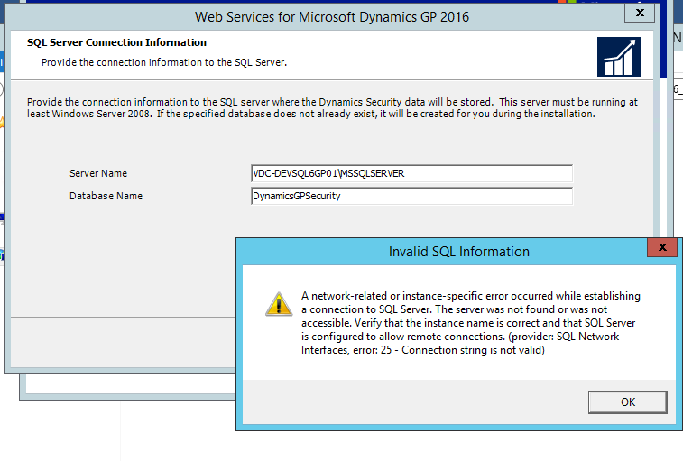

    • Beat Bucher
      January 27, 2017 at 9:58 AM
      Jason,
      For what it’s worth.. have you tried to append MSSQLSERVER in the back of your SQL server name ? when installing your GP SQL server without specifying an instance name, SQL will use a default name, but some installation software actually need to have that instance name specified.. (check for the proper instance name in the windows services).
      Beat Bucher
      Montreal QC/Canada
      +1-514-489-4267
      GP2013R2 / MR2012 CU14

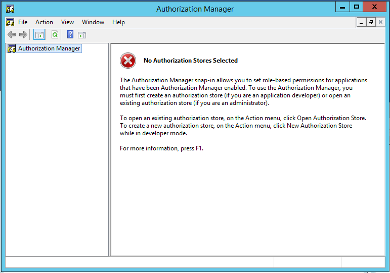

    • Ken Allgood
      January 27, 2017 at 10:23 AM
      From what I’m seeing, it looks like you have Authorization Manager for Window Server set up.  I have to admit, I’m not familiar with this.  Do this to see if you have an Authorization Store configured or not
      To start Authorization Manager
      1. Click Start , type azman.msc in the Start Search box, and then press ENTER.
      Click on Authorization Store on the left.   Mine says No Authorization Stores on the right/main window on any of our servers…
      If it gives you a login challenge, and you cannot get past it, then I think you found your problem.
      Here’s some more info on Authorization Manager –
      https://technet.microsoft.com/en-us/library/cc726036(v=ws.11).aspx
      I might be barking up the wrong tree here, but based on your error, seems like a possible route to look into….

    • Jason Headrick
      January 27, 2017 at 10:26 AM
      I get the same thing.  I compared this to our GP2015 environment (current Prod that works – and i did the install) and it is the same, i can’t find any difference.

      I see this discussion was from just a few weeks ago.Ā  I’m getting the same errors as you…Ā
      “Access to the Authorization Manager store was denied”
      When I try to connect using the suggested “servernameMSSQLSERVER”, I get the same error as well:
      “A network related or instance-specific error occurred….. etc etc…
      …. etc etc…Ā  Verify that the instance name is correct … etc etc…
      …. and that SQL Server is configured to allow remote connections… etc etc “
      I’ve had my network guy watch the firewall logs as I was attempting to install, there were no firewall blocks… bunch of traffic flowing through 1433.Ā
      did you ever get through this? Thanks!

      FYI – for anyone reading this in the future, I opened a Premier ticket with Microsoft, this solution worked for me:
      Hi Terry,
      I’m pretty sure I know what the issue is here. Can you confirm for me whether or not TLS 1.0 has been disabled on these machines? I’ve recently been doing internal testing regarding GP compatibility with TLS 1.0 disabled, and I get this exact error message when installing Web Services where TLS 1.0 is disabled. Currently I don’t have any workarounds except to activate TLS 1.0 to get Web Services installed.
      I’m not sure if you can enable TLS 1.0, install WS, then disable it again, I haven’t gotten to that phase of my testing, but I’m pretty confident that this is what you’re running into.

      Hello all, sorry to bump an older thread, but I have information that may be relevant to a resolution. With the PCI Compliancy changes due this summer regarding TLS 1.0 deprecation, we’ve been doing internal testing on GP when TLS 1.0 is disabled.Ā
      If you try to install Web Services with TLS 1.0 disabled, you’ll receive the following error:
      “Access to the Authorization Manager store was denied.”
      Currently, the only workaround I’ve been able to find is to enable TLS 1.0 again, and perform the install . TLS 1.0 appears to be required for the Security Console as well, so for now I’d say TLS 1.0 is a requirement for Web Services until we find out where that error is coming from.Ā
      Otherwise as long as you’re connecting to a SQL instance that supports TLS 1.0 being disabled, there aren’t any other issues we’ve identified so far with running GP on a machine where TLS 1.0 has been disabled. See the following links for more information, including configuration and update information for TLS 1.0 disable compatibility against SQL. The updated SQL components are required for GP connectivity against the versions stated in the first link. The instructions are for SharePoint, but that’s the guide I followed to get my environments connected.
